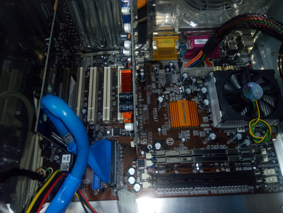

The worst thing happened to me, I have a Jetway J-635CS, 2x 1gb DDR 400 Kingston, Radeon HD 3650, Pentium III 1.1 GHz SL5QW Coppermine aka fastest coppermine, and pretty much the best 370 setup.
I switched PSU's and suddenly no post, switched back to the old one still no post, the CPU fan spins for a second then nothing, the cpu gets warm, but the chipset is cold, I checked everything seems the mosfet shorted so i can't get correct reading on the caps, and the GPU's caps blew. I pray that I'll manage to fix the motherboard, even if I have to re-solder the whole thing from ground up, hope the chipset is fine because that would be a real pain in the ass to source and solder even then it might not be compatible.
Just had to write this down here as a 635 user in pain 😒 If anyone has any advice I'll be super thankful!
Also I've got a dead Intel D815 board, it worked 10 years ago and the whole PC was just stashed away, the caps were dead so I recaped it and it still wont post,
why are they selling those 2 ancient boards for huge amounts of money? I can't find anything under a couple hundred dollars.
