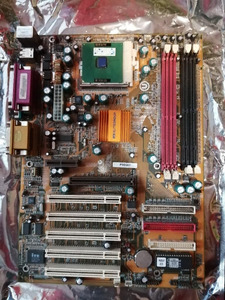

Reply 3 of 72, by Nemo1985
I'm sorry for the bump, I finally found this motherboard, but it seems a bit different from the one in the picture, is it an older revision probably?
The attachment photo_2021-01-09_19-59-21.jpg is no longer available
What do you think?
Reply 4 of 72, by BigDaddyM
I Think it is 1.5 revision. Tualatins are supported on 1.6. You can check in corner od the board, near ram slots

Reply 6 of 72, by BigDaddyM
Sorry but I was wrong, revision 1.5 does support tualatins 😀

Thank you for the tip, indeed the one I bought has some bulging caps, I was thinking to go for a full recap, just to be on the safe side.
Reply 10 of 72, by Nemo1985
I just received the motherboard, I can confirm it's a Rev 1.5A.
Ecs has updated the website, any advice where I can find the latest bios?
Edit: the mb doesn't work, it throwed E0-- error a couple of times and then now it shows -----, I tried to change the cpu and ram, but no results :\

Reply 13 of 72, by Nemo1985
I have finally been able to recap the ecs board and brings it to a new life.
As I always do I checked the microcodes and I noticed a weird thing, some of them are duplicated there are more version of the same microcode so I took the chance to remove the duplicates and update the others with the latest version.
I also spotted in the bios a hidden setting which let the system choose the updated ones, that explain the reason of the duplicates, I also made visible some more settings like ide busmaster and the boot speed selection.

I sent my motherboard to a user which is going to fully recap it, I'm waiting for the response, it is in his hands already.
Reply 18 of 72, by VooDooMan
Nemo1985 wrote on 2021-04-08, 09:29:
Ok, I hope you will get it back fast so that you can have more fun with it 😀

Reply 19 of 72, by Nemo1985
I'm having such bad luck with hardware, well maybe life in general, nowadays.
The motherboard came back recapped an (apparently) fixed.
I didn't try with the installed cpu and memory (P3 866 and 128x2 ddr), I went ahead and change both cpu and ram, guess what? ---- on the debug card and no way to make it boot.
I took it off from the working bench, briefly tested another component and mounted back, this time it booted (with the original cpu and 128mb ddr), so the problem lies in the cpu or memory.
If I change them it goes nuts.
Next I swapped the ram to a bank of sdram, guess what? It stopped booting once again! I noticed that on the debug card it gives a reset signal every 5-10 seconds when it can boot.
Anyone else had issues with switching from ddr to sdr?
