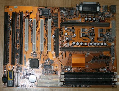

Hi, is anybody able to identify this board? Looks very nice but it doesnt run. Maybe its a faulty BIOS, but I dont know where to look for an image? I add mine for reference, but maybe its bad...Thanks!

At first I thought it was an IWILL DBD100, but the chipset heatsink and bios sticker are a dead giveaway for pc-chips.

so I'm looking it over, and its missing the APIC chipset. So its a single-cpu board unless you find that little board that goes into that little slot to the right of the bios.
GOOD LUCK.

PC Chips M720. Doesnt seem to be worth to spend more time with. Already asked what this slot may be used for. Now I also found a BIOS file that has only 471 different bytes to mine..! I will try that one and if it doenst work..away with it 😵
