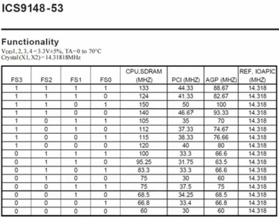

Experiences with K6-2, K6-2+, and K6-3+ CPUs , motherboard cache and bus speed:
K6-2 - works fine at 120Mhz fsb with motherboard cache enabled
K6-2+ - must disable motherboard cache for 120Mhz bus speed. Seems to work with motherboard cache enabled up to 110Mhz bus speed.
K6-3+ - must disable motherboard cache for 120Mhz bus speed. Seems to work with motherboard cache enable up to 110Mhz bus speed. May not be fully stable even with motherboard cache disabled. Will do more testing later.. but there seems to be some sort of timing issue with the K6-3+ where there isn't with the K6-2+. Tried 2 different K6-3+ 450Mhz CPUs with the same exact results.
Results were exactly the same between 2 version 1.04 motherboards even though they have different branded motherboard cache.
The version 1.03 motherboard I have seems to not handle the higher bus speeds quite as well.
The K6-2+ 550Mhz was hitting 660Mhz (120x5.5 or 110x6) easily.
Both K6-3+ 450Mhz CPUs seemed to have some timing issue with the motherboards and going over 630Mhz. Will be testing with some Via based motherboards to see if I can clock them any higher.

Ooo!! the infamous hidden settings. Finally found them!
Dudes, it goes to 150mhz?!? Wtf?! Lol
Ummm 150 x 6x is 900!
Someone emerse this in ln2 and grab that cpu-z verification!
