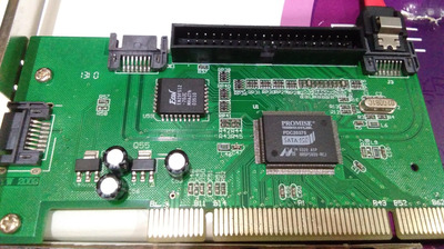

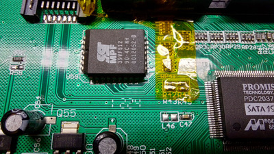

I think this card is an unbranded OEM version of the well known Promise S150 TX2 PLUS controller card. I am using it on a 440bx intel motherboard.
Problem is I can't get an attached drive (any drive) to boot from this card or show up as a drive in DOS7.1 (under fdisk).
When I boot the PC the BIOS expansion ROM flashes up " Fasttrak 378 - Bios v1.00.0.37 (c) 2003.
It then scans for drives and doesn't find any. Only other option is a choice to enter the bios 'fastBuild Utility 2.01' . Inside that my drive will get detected but the only options are to create a raid array.
Are these oem cards locked to work in raid mode only or crippled in some other way to stop booting from them>>

Pflash errors with "Controller NOT FOUND!" message.
From what I have found out the PD200378 was only used by promise on some Asus motherboards for extra sata/ide ports. I will try some of the asus utilities to flash it.

You MUST make an array. Even if it is only 1 disk.
That is how those controllers work. They have to have an array set up.
Once the array is set up, it will then let you initialize it and it will work in DOS/Windows/whatever.
And it isn't because it is a knockoff controller. Every single add-in RAID controller requires you to make an array to be able to use the disk(s) attached to it.
If you want to boot from an add-in controller, you will also need to set the BIOS to boot from either add-in card or SCSI as the add-in cards are seen as SCSI controllers.

After messing around I now have it working.
The official Promise bios flasher tools wouldn't flash the card so I just erased the raid bios. It worked. When I boot from the card it now lists the connected drives and also shows a ' No bios found' message.
One annoyance is the PCI card takes 6K of conventional memory from somewhere. No drivers or tsr is loaded, Dos is just reduced to 634KB available memory in a clean boot with nothing else loaded.

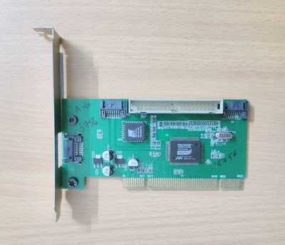

Just wanted to update that I found a similar but not identical looking Promise card which works on my SS7 motherboard. The manufacturer's old site had drivers for this card with this packaging, it identifies as InnoSupply PC17, but is in fact a Promise SATA150 TX2plus card as it appears in the BIOS/Device Manager, provided drivers is version 1.00.0.27. Have attached the drivers here since the InnoSupply site has been Wordpressed, and old files seem gone. I assume Promise official drivers should also work but I didn't try looking for them.

hello,
oeuvre wrote on 2019-07-06, 12:07:
Looks like you got a card that isn't what it was... promised to be.
I have been working with this card lately and I can assure you, that this Promise card delivers exactly what it had promised 😉
I have two cards - genuine Promise Fasttrak S150 TX2 with PDC20371 chip and Chinese clone based on PDC20378 chip. These cards behave exactly the same - with hard-drive connected they hang during POST with error message stating that no array is defined. You need to configure an array to use a single drive, but then you won't be able to use this drive / image taken from this drive using different controller.

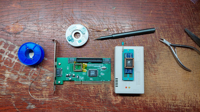

First and foremost, AvalonH probably used pflash tool that is distributed by Promise inside their BIOS packages. It has an /e switch for erasing the flash on a card. I was not able to use it. For both cards I own there was an message, that command suceeded, but apparently it did nothing. Probably it's caused by my motherboard that has some kind of BIOS flashing protection that cannot be disabled. I could have used a different motherboard, but I wanted to explore different approach.
As some of you may have noticed, PDC20378 was only officially released on Asus motherboards as integrated SATA controller. Genuine Promise SATA 150 TX2 Plus used PDC20375 while Fasttrak S150 TX2 used PDC20371.

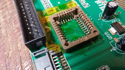

On my chinese card I have desoldered the BIOS chip using the heatgun and put PLCC socket instead for easy external BIOS flashing (I used TL866II). I tried to flash latest BIOS intended for Promise SATA S150 TX2 from Promise website, but the card would not show up during the POST. Probably the BIOS is tied with specific PCI device identifier and it will not POST on a different card, so I tried something different. I looked into the Asus PC-DL BIOS and I have extracted Promise BIOS(es) out of it. It's plural, because there are two modules for Promise called "SATA378" and "RAID378". Probably in the motherboard BIOS there is a setting that could be used for switching between IDE and RAID modes. But guess what - the dump of Chinese Promise BIOS chip is 1:1 exactly the same as the RAID378 module exctracted from Asus motherboard! I believe that what Chinese wizards did with these cards, was that they somehow obtained PDC20378 chips that were intended for Asus motherboars and they just built cards around them.

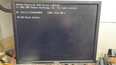

Anyhow, I just flashed "SATA378" on the BIOS chip, I have been greeted by "SATA378 TX2plus(tm) BIOS Version 1.00.0.33" POST message and my SSD got detected properly. Success! ...and quite interesting mention of TX2plus. The same must have existed on Asus motherboards.
Another part of the story was to get w98 driver for these cards. Seems that Asus has drivers for this controller running in RAID mode only on their website and Promise didn't released any card with PDC20378 chip, so there are no drivers for it. The solution was to just force installation of Promise SATA S150 TX2plus drivers. The Windows complains about these drivers not being intended for this card, but after confirmation everything seems to be working correctly. This could probably be resolved by easy .inf modification, but I didn't bothered with that.
In the attachments you can find some pictures and "PROMISE.zip" which contains bioses, drivers and screenshot proof that card works properly under Windows 98. Here is a directory listing:
