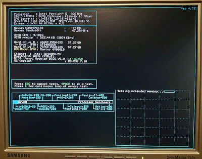

Reply 12 of 459, by vitalm
Thanks for the very good explanation! It's not usual, even here on vogons. Earlier (two years ago) I had tested all official BIOS revisions for my P3B-F rev.1.04, changed varios BIOS options, but nothing helped.
Is it possible to mod BIOS to properly set and report unlocked Klamath as 2x with L2 enabled?
As no retail CPUs had 2x multi, all Slot1 boards I tested had 3 or 2.5 as the lowest ratio in BIOS. When you set 2x by jumpers, it shows by BIOS as 2x with L2 disabled.
And when you set 2x with L2 enabled by jumpers, both BIOS and utils like Speedsys report 5x with L2 enabled (60x5 instead of 150x2 for FSB actually set to 150).
gerwin has many posts about the "undocumented 2x with L2 enabled", starting from year 2009, e.g. Re: slot 1 Mobo
2x multi (with L2 enabled) is very useful for switching FSB "on the fly" in Win98, varying from 50 MHz on 440FX/LX to 150 on 440 BX.
W98SE+NUSB3.3, 7AJA2 (KT133A+686B), Athlon XP-M (3x100-16.5x150 MHz), FX5900, Voodoo1, AWE64 ISA (VXD) connected to Line-In of Vortex2 rev.B0AAAA (VXD 2041) for DOS games CD Audio emulation by Daemon Tools 3.47 (volume can be changed in DT drive settings)
Reply 13 of 459, by DenizOezmen
Well ... the processor itself does not really report its speed per se. Even the BIOS does a speed test to determine the internal clock frequency. If the FSB clock equals one of the standard values (i.e. 66, 100, 133 MHz), the BIOS compares the measured value against pre-defined tables and chooses the best match for display purposes (during POST).
The multiplier is actually read from a model specific register (MSR 2Ah) of the processor. However, the appropriate (read-only!) part of the register only contains a more or less arbitrary bit pattern, which has to be translated to a sensible value for display in the BIOS setup screen. (Once again, a table of fixed strings is used here.)
So, my guess would be that a Klamath core processor running with a multiplier of 2.0x (and L2 cache enabled) reports the same bit pattern in MSR 2Ah that later got redefined for the 5.0x multiplier of newer cores. If so, the BIOS should report the correct core frequency (at POST), the correct FSB frequency in the setup screen, but the wrong multiplier in the setup screen, is that correct?
In that case it should theoretically be possible to implement an exception into the BIOS. However, it would really only correct the displayed value within the setup screen, which seems like quite a bit of work for a very small gain. Any software that reads the multiplier from the MSR the same way (and possibly uses it for FSB calculation) would have to implement a similar hack, since the information returned by the processor is simply ambiguous in this regard.
By the way: Is the speed selection in the P3B-F's BIOS setup fully unlocked when using a Klamath core, i.e. can you choose the multiplier yourself in jumperfree mode?
Reply 14 of 459, by vitalm
Thanks for the quick answer.
DenizOezmen wrote on 2020-04-05, 22:52:
... the BIOS should report the correct core frequency (at POST), the correct FSB frequency in the setup screen, but the wrong multiplier in the setup screen, is that correct?
Yes. Re: Pentium 2 @ 133 mhz project ,help
I agree that the gain is very small. My thought was like "If CPU=Klamath then show 2x instead of 5x".
Yes, exactly like on Abit BX6 (unfortunately, the BX6 has no FSB/4 divider for PCI). If Klamath was manufactured before August 1998.
