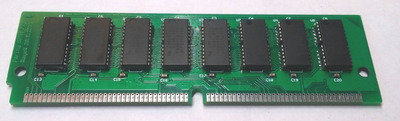

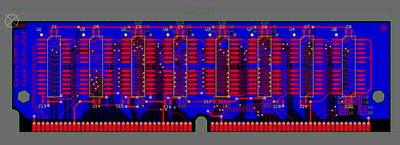

I just finished parity SIMM 72-pin design (just 2-layers to save money but pwr/gnd planes could be added in future if needed).
I plan to send a batch of PCBs to JLC until end of this month to get advantage of 2$ discount for 4L 50x50mm for PentiumMMX mobile interposer.

I received my PCBs from JLCPCB and started assembly the SIMM module. At 1st test stage I soldered only 8 DRAMs of 12 and it works fine (memory tests passed, even it's only 2-layer design) but I found a mechanical problem. I didn't get aware of PCB thickness and now I see the original SIMM is 1.2mm thick PCB while I made all PCBs on JLC default thickness 1.6mm. The module fits into a socket but it's tight. Some sockets are relative OK some are very tight. I'm bit afraid of spring-pins to not deform them too much so I rather not left module in a socket for long time and pull it out. When I googled about this I found Alex. Groza article about his 30-pin SIMM and he catched at the same thing. If I would read his article (that I already had downloaded for offline reading) before I could order the proper PCB thickness...
So, never mind, the price for this PCBs was ~5,5$ and I use it for testing in my Alpha64 after I will solder the rest of DRAMs and set the ID bits. Then I will give another try in JLCPCB when there will be a chance or I will collect PCBs for a next batch...

Yes, I know. My first SIMMs in 1.6 mm thickness were a very frustrating experience for me as well. And exactly as you say, some of sockets do accept 1.6 mm PCBs but they look a bit stressed.
I re-did mine at JLCPCB in 1.2 mm, they work great and are a perfect fit for the SIMM sockets. On the downside, the black soldermask quality is not very good. The JLCPCB green one is better, similar to the purple soldermask from OSHPark.
Good job on your SIMM design! Glad to hear it works on a dual-layer PCB.

I soldered the rest of DRAM chips (I had to borrow them from another working parity module because I don't have any other donor now) and it works fine in Alpha64. So when possible I will let manufacture them again with right thickness.
I'm not a fan of black or white opaque solder mask, I like visible traces. So I usually keep default green mask, only once I made red.

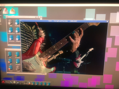

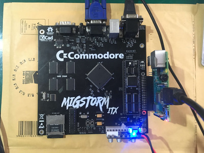

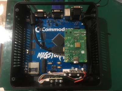

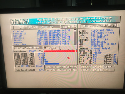

MigStorm ITX is working now.. basically I used the Minimig 1.1 and 1.3 design and adapted it for a full 68000 socket (with bus voltage transceivers 3.3/5v correction) for use with the Pistorm CPU accelerator, plus ATX power adoption. It fits nicely in a SFF ITX case to give you an OCS/ECS accelerated Amiga experience. Build, flash, and install a 68k CPU or Pistorm classic accelerator with Musashi or EMU68. Use Pistorm w/ Musashi + Amiga OS 3.x to take advantage of built-in WiFi. With use of the Pistorm, it is fully capable of playing Duke Nukem, Quake, etc on Amiga OS.
https://github.com/wiretap-retro/MigStorm-ITX
