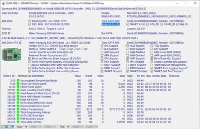

The SATA 600 SSD should negotiate down to SATA 150, I just checked and my Gigabyte 8IPE775P has a Samsung SSD 840 that does.
Does your SSD support Generation 1 (is G1 checked)?
file.php?id=96794
    97.15 KiB
    410 views
    SATA 600 SSD running at SATA 150
