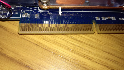

Reply 31 of 43, by Cbb
Mamba wrote on 2020-12-30, 08:48:
- Remains to be seen if a NV40 card can be modded even if it has no blank spot on the agp port (without electrical traces of course). @J'AWS you can help maybe in that department.
I personally killed two working ASUS V9999 cards by cutting this slot on the connecor. They won't start anymore neither in AGP 2x neither AGP 4x/8x slot.
Now I dont wanna try my luck anymore cutting a good 6800Ultra. So it will stay not for 2x board. 😀
Reply 32 of 43, by Mamba
Cbb wrote on 2020-12-30, 16:30:
Thank you Cbb.
You mean a cut on a pcb same as the picture?
Or a cut on blank pcb spot like v9999ge ones?
https://thumbs.worthpoint.com/zoom/images1/1/ … 3319d420247.jpg
Reply 33 of 43, by j^aws
FYI, a 7 year old thread with my 6800GT running at AGP 2x on a 440BX:
Re: Would this mod to this Geforce 6800 from AGP 1.5v to 3.3v kill it?
Newer than 6 series involved messing with AGP GART drivers, of which there are various. This is something I didn't document when I tested a 7 series at AGP 2x.
Reply 34 of 43, by pshipkov
Interesting thread.
In my experience, the graphics performance with this class hardware was almost entirely CPU bound already, considering GPUs from the same time, or later.
Going for later video cards will bring little gain. Get the best CPUs instead.
At least i don't see significant improvement with the bunch of later video cards that i tried.
I confirm that GeForce 6800 GT/Ultra works well with modded AGP connector.
For example this fancy SDI version of Quadro FX4000 which is the pro equivalent of GF 6800 Ultra works just fine - https://www.petershipkov.com/temp/retro_pc_im … adro_fx4000.jpg
