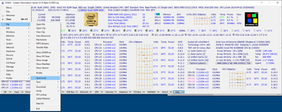

In general you can Right/Click to get a menu including from the Tray Icon
file.php?id=99526
