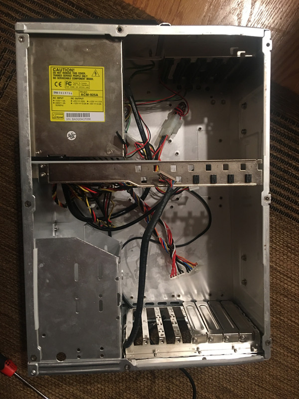

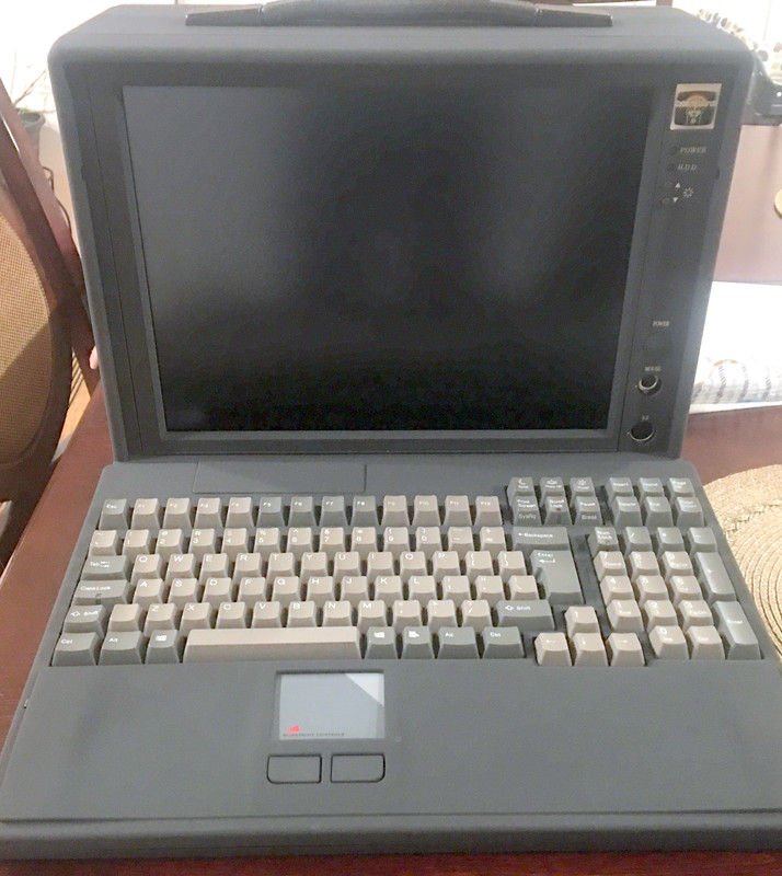

Ok. I thought that I bought Dolch computer, but it is turned out to be some luggable look-a-like with no motherboard.

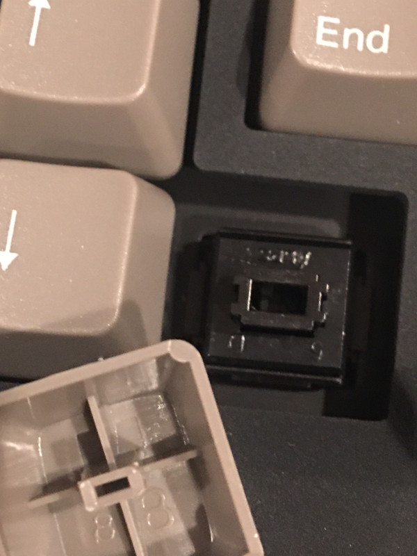

It is strange. Keyboard is large din connector, with touchpad and (ps2) and it has windows keys 🙁
I checked keycaps and there are non cherry type 🙁
Inside. It has no motherboard, but it would be nice to put some

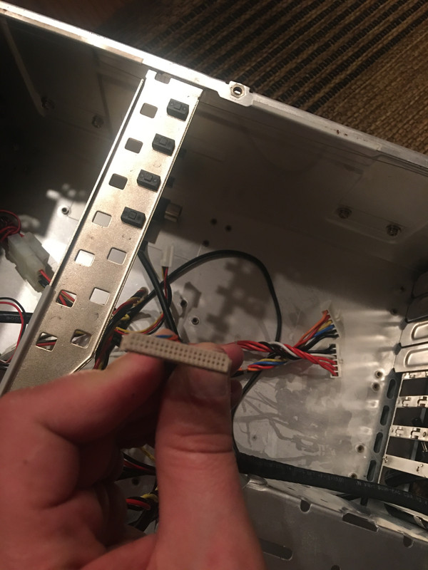

Display seem to be connected to the board (graphics card) via this connector:
Does anybody knows what motherboard or video graphics card has such connector? I need to test dispaly and it would be nice to install some motherboard in it.
Reply 1 of 18, by Warlord
my guess is some kinda LVDS connector. or pre LVDS. Its 40 pin. Youll need some kinda adapter once you figure it out. You might need 2 or 3 adaptors for all I know. Try to find out the manufacture of the case, or take it apart and find out what LCD it has.

Reply 5 of 18, by RichB93
As for the PSU/system layout, its AT (not ATX), so you're mostly looking at a Pentium MMX, although there are some later boards with an AT layout (but they're harder to find.
Talking of hard to find... that LVDS connector is going to be difficult. I'd recommend installing a cheap Chinese LCD instead which has its own controller card that goes to VGA. That'll be the easiest thing to do, and also means that you'd get a better quality LCD (chances are this one is either DSTN given the age of the machine, or it still has an awful refresh on it), which is compatible with any display adapter.
This would make a bitchin' Pentium MMX + Voodoo gaming luggable.

Reply 7 of 18, by shamino
If you have any interest in using the existing LCD then a starting point would be to find a datasheet for it. Look for a part number on the panel assembly.
But I agree that swapping it out for something "known" is probably more practical.

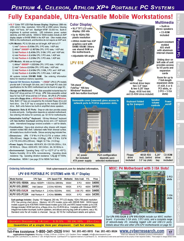

Reply 9 of 18, by PC Hoarder Patrol
Not sure what vintage your case is but they seem to have similar systems back to Pentium days
fod4000.pdf
33.66 KiB
16 downloads
Most of the useful stuff on archive seems lost but here's their 2004 product guide
https://docplayer.net/94653433-Pc-systems-han … -engineers.html

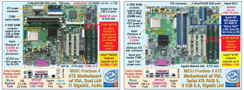

Reply 10 of 18, by Niezgodka
PC Hoarder Patrol wrote on 2021-01-16, 09:35:
Not sure what vintage your case is but they seem to have similar systems back to Pentium days […]
fod4000.pdf
That is a great find. Btw, they had a bunch of great hardware 🙁
They listed a motherboard, but I don't see such connector on it.
For the dispaly, they stated that it is 15.1 TFT. Probably like you said, the best idea will be to substitute the 15.1 3:4 dispaly with standard connector.
I wish I would be able to make it into P166 retro gaming machine, or somehow slide Amiga 1200 mobo into it.

Those are all atx boards. It's hard to tell from your pictures, but the case you have looks like AT?
Also, the location of the PSU and slot covers is totally different.
Yours is likely a much older model.

Reply 14 of 18, by dionb
Ozzuneoj wrote on 2021-01-16, 20:09:
"Much" is a big word. Max 5 years older given the Windows keys.
This is definitely babyAT, with 9 slots and a few cm above it where the DIN keyboard connector goes, with P8+P9 power connectors. Should fit any babyAT board provided there's nothing too tall in the top few cms of the board. Only challenge is LVDS, and possibly PSU output.
Pics?
Could well be Alps 😀

Pics?
I think they might be Alps. Need somebody to confirm it. Even if it is not, the keyboard is clicky and very nice.
oooh nice and large screen, the connector looks to be pretty standard LVDS
if you know the resolution you can just buy a generic LCD controller for a few bucks
@ini, can you or anybody link me such adapter? According to the their add flyer, the display is 15.1 TFT with 1024 x 768
Reply 18 of 18, by imi
most motherboards I have with on board LVDS interface use this connector, though thinking about it most generic LCD controllers actually use a pretty standard pin-header instead nowadays, though if you check the other end of the cable you may still find one with appropriate connector
