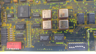

Reply 22 of 60, by jnemo2004

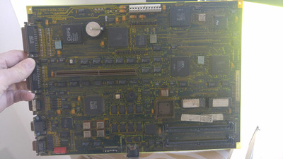

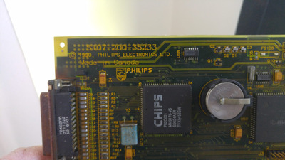

Good afternoon (it's Spain). I have recently bought the Philips 5107-200-35233 motherboard and although it has oxidation in some parts it may work. I'm going to clean it with isopropyl alcohol and then I would like to connect it but it has two DIP switches and I don't know how to configure them. Does anyone have the manual? Thank you.
Reply 23 of 60, by snufkin
Looks pretty close to this: https://theretroweb.com/motherboards/s/dec-pc-386sx-ce-p3348
https://theretroweb.com/motherboard/manual/33997.pdf
Not sure about the DEC listing there. Looks like it was used in the Philip P3348: https://www.it-info.hu/2020/09/08/retro/

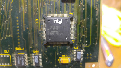

Reply 25 of 60, by jnemo2004
Good morning, yesterday I connected the motherboard and a capacitor exploded. Can you help me identify the capacitor, it is the same as the one next to it.
Reply 26 of 60, by DAVE86
jnemo2004 wrote on 2023-01-30, 07:26:
The 226 marking tells that it is a 22uF 10V smd chip tantalum.
Reply 27 of 60, by snufkin
I think the 20K line says that they're made by Kemet and are 20V rated. Replacement doesn't have to be Kemet, just 22uF and 20V rated. Actually, depending on which voltage supply it's connected to then other voltages might also be ok. Not sure about the size, maybe 2917 (7343 metric, so 7.3mm long by 4.3mm wide). Something like this maybe: https://uk.farnell.com/kemet/t491d226m020at/c … HP-STM7REC-RP-1

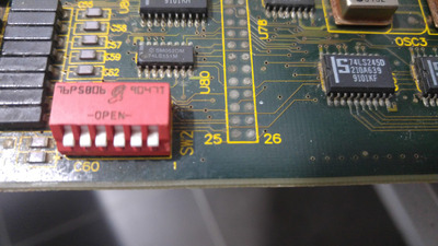

Reply 29 of 60, by jnemo2004
Thank you very much for the information, I have already ordered the capacitors. I have a question to ask you, I will connect the motherboard to a VGA monitor but I am not sure how to put the SW2 switches (as indicated in the manual in a previous post). The plate has come with all closed.

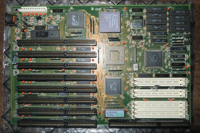

Hello, I'm trying to identify this motherboard. I was able to find motherboards that look similar to this, but with a different pin layout (next to the memory slots). I'm trying to find the model/maker in order to try to find the manual and figure out what each pin means. Some of them have a label, but others don't. I still need to figure out the pins for the external battery, power on indicator and keyboard lock. Thank you so much!

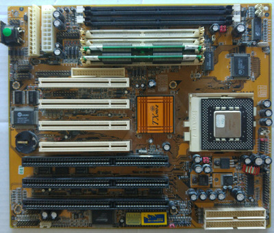

Reply 31 of 60, by jnemo2004

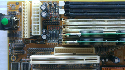

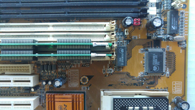

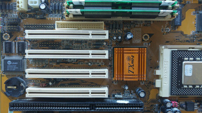

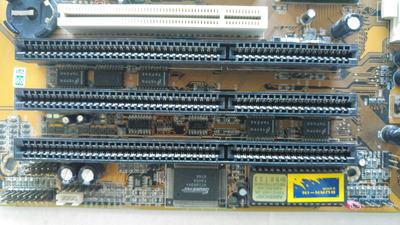

Good morning (in Spain), could you please help me to identify this motherboard. Thank you very much
Reply 32 of 60, by W.x.
All you need to do, is to put "PC Chips TX Pro-II" into google, and viola...you go
https://theretroweb.com/motherboards/s/pcchips-m571-v3.2-a
it's obvious it is PC Chips, with "Burn-in" sticker, and also, by special chipset name Tx Pro, which only PC chips used.
https://hardwaresecrets.com/chipset-aliases-t … -vx-pro-and-co/

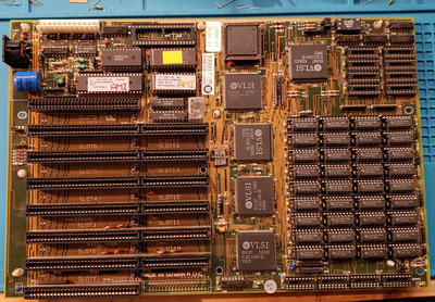

Reply 34 of 60, by Chupperson
I need some help figuring out what this 286 motherboard is. It's almost identical to the Biostar MB-1212V except for some components on the edge near the ISA slots. Maybe it's just an earlier revision. Does anyone know what the logo on the serial number sticker is?
I actually found one on eBay but the seller doesn't seem to know any details about it either. https://www.ebay.com/itm/185759011221
Other very similar boards:
Shuttle 12MHZ ZERO-WAIT 80286 TURBO
DTK MBVLSI-168 (V.2)
They all have different jumpers on the side with the ISA slots and I haven't found any documentation with "JPA" and "JPB" listings yet. I just removed the battery and am attempting to make sure I have it set correctly for an external lithium battery. As far as I can tell, all I need to do is move JPA over (above the JP17 battery header) so it doesn't connect with the battery terminals but a little confirmation would be nice to have.

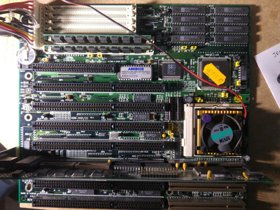

Reply 37 of 60, by jnemo2004
Hello, I'm here again.

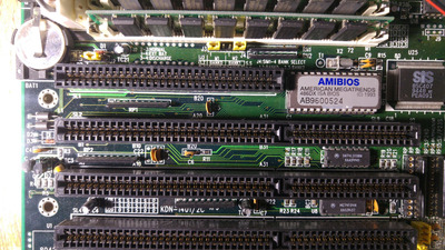

Could you please help me to identify this motherboard (486)?
Thank you very much.
Reply 38 of 60, by Dorunkāku
jnemo2004 wrote on 2023-02-08, 15:23:
https://theretroweb.com/motherboards/s/epox-pronix-gxa486sg
