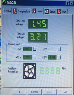

My PSU is an EVGA 450Watt (450BT) 80 Plus Bronze PSU. It randomely stopped working and then it started working after couple of hours. Is this of the wrong spec? Is this providing enough power to my Socket 370 Build? And do Retro PC’s consume a lot of power?

EVGA's website says the 450 BT can do 18 A on the 5 V rail, with a combined max output of 90 W on 3.3 V and 5 V rails together. With just the pair of 1.4 GHz Tualatins pulling over 60 W at max load by themselves, then adding the consumption of RAM, video cards, sound cards and motherboard components, you're probably pushing the PSU to or beyond its limit for 5 V and 3.3 V rails.
I would recommend either getting a new PSU with a more powerful 5 V rail, or refurbishing an older PSU from the Athlon XP era. I know Corsair's current TX and TX-M series can do 25 A @ 5 V, at least on 600 W+ units, I'm not sure about other brands or models.
