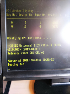

For 2 of my machines, I bought a XT-IDE/CF Lite solution some time ago. Both came with a DOS loaded CF cards. They work like a charm.
For my last one, I bought a XT-CF lite 4.1 without a card.
So did some research and tried it on my W10 like instructed here:
http://theinstructionlimit.com/installing-ms- … -to-ide-adapter

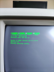

In Oracle it boots fine, in my machine (IBM clone with Turbo XT board) , the card gets detected but hangs at C>C.
So back to the W10 machine and through Oracle, I do FDISK /MBR, I put it back in the machine and then it says 'Missing Operating System.
I dug out my DOS 5 discs and I try to do it in the XT but I always get the message: there are no fixed disks.
Next attempt: try it with a socket 7 system. Again, the CF gets detected but DOS and FDISK say: no hard drive to be found dude...
Third system: Tandy 1000TL with also a CF lite installed: same thing.
My 2 premade cards work fine so I am missing something here.
Is this an issue with these adapters, the cards (tried 3)?
BIOS issue on these 2 adapters? One seems from 2013 and the other from 2015 so not really up to date 😀

Reply 6 of 31, by Murugan
Ok.....so I cloned it on a 256mb card. Original it's a 128mb with 60mb partition.
All went seemingly well using Win32diskimager but....again 'missing operating system'.
Getting tired of this.
What am I missing???!!!
I also tried Driveimage xml but when restoring the image, it complained about the drive parameters being different and it gave an error when it wanted to adjust it.

Reply 8 of 31, by Murugan
I tried a lot of things...the first times I created the CF in Oracle,the XT hung on C>>C. After doing fdisk /mbr in Oracle again, the XT said missing operating system.
I just cloned a working 256mb card on the 256mb one I want to use but it keeps saying missing OS????
Maybe I am preparing it wrong?
In diskpart W10, I do a clean and then it does't work. Then I create a partition of 244mb since diskpart says it's 244mb (leaving like 245kb unused it seems). I assign a drive letter and format it in FAT.
