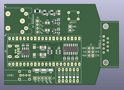

Hall​o!

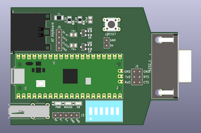

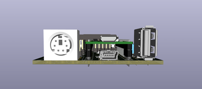

​While laying out some of the components on the PCB, I was noticing that I have a lot of space.
​As a test fit I added a ch340N to the board with a mini USB port. The idea is that the ch340 connects to the pi picos UART0 and will allow the user to easily configure the adapter on another computer.
​The ch340N is a small and cheap UART to USB chip with drivers for win XP all the way to win 10. I showed in a past video that I was accessing the config terminal with another pi pico acting as a UART to USB converter, this would let the user do the same but without having to get an adapter.
​What do you think of the idea? the ch340 is about 40 cent on JLC so it might be worth it.
​I know that the 3d model for the mini USB port doesn't match the footprint, it's just there for fitting really.

Reply 101 of 231, by CalamityLime

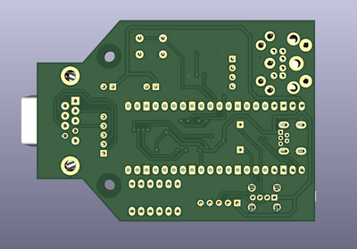

I've started routing the traces. I forgot how slow of a process it was.
Still, getting to a final shape that's more square than the original.

Reply 102 of 231, by Sphere478
Ps2 footprint may fit under the din also

Reply 103 of 231, by CalamityLime

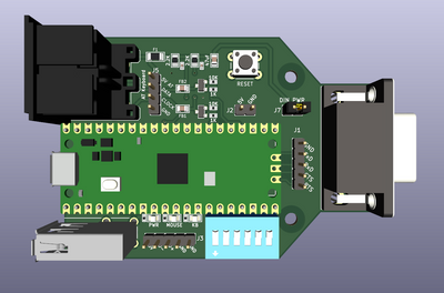

So the trace routing should be done now.
Two holes were added for the sake of a case and J7 labelled "DIN PWR" allows you to power the device from the keyboard port of your PC.
I don't really recommend using it unless you know what you're doing since it connects the power of everything together.
So you'd have to be careful if you KVM gives out power over the USB port or if you were using the mini USB port to configure the device, you could back feed a connected computer.
If it doesn't pop the polyfuse on the adapter it would pop the fuse on the keyboard port.

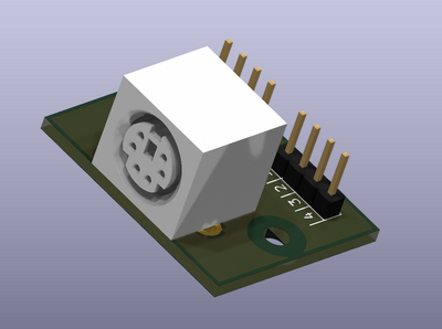

OH, almost forgot. I added the footprint for a ps2 port on top of the 5 pin din port just in case someone wanted a female ps2 port there for some reason.
That's all I got the moment.

Reply 104 of 231, by Sphere478
CalamityLime wrote on 2022-05-17, 21:22:
Yay! I helped!

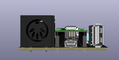

So there is a micro on the pi, I assume for interfacing and programming it,
Then there is a A on the board. I assume for a usb kb/mouse
But what’s the mini usb under the pi for again? For power?
Btw, combining multiple 5v sources should’t hurt anything so long as they are common negative. That common negative could even source back to house neutral, so long as they are tied there. shouldn’t be any issue. (Beware of reversible plugs) Except maybe line noise? But no biggie.
Sphere's PCB projects.
Reply 105 of 231, by CalamityLime
Sphere478 wrote on 2022-05-18, 04:36:
Then there is a A on the board. I assume for a USB kb/mouse
But what’s the mini USB under the pi for again? For power?
The micro on the pico is part of the pico. You can use it to program the pico or you can use a USB OTG cable to plug in a KB and mouse.
The USB A uses the break out pads on the bottom of the pico. The pico and the A are wired together, it just gives the user a less silly way of plugging in a KB and mouse.
The USB mini goes to a ch340N which is connected to UART0 of the pico. That is just a cheap UART to USB chip. Plugging into that port will make the pico appear as a COM on your PC and you can use Putty to connect to the configuration terminal.
The Pico has 2 UARTs caked into it. I use UART1 for the max232 and I used UART0 for the real debug logging; printf.
However I also made the configuration terminal available over UART0 to make my life easier while making it and I left it available. I decided to add a 40 cent chip to the PCB to make it easy to use and if someone didn't want it then they can leave it out.
You can also power the device using the mini B. Which is probably what I'd do TBH. USB micro is terrible and I went out of my way while programming it to handle the USB micro having an intermittent connection but even so; give it steady power, especially while it's saving your settings to flash.
Btw, combining multiple 5v sources shouldn't hurt anything so long as they are common negative. That common negative could even source back to house neutral, so long as they are tied there. shouldn’t be any issue. (Beware of reversible plugs) Except maybe line noise? But no biggie.
Connecting multiple 5v sources together will just get a little burst of EMF when they are connected. The whole system will tend towards the higher voltage source but it should "balance" itself generally speaking.
The issue is if the retro PC is turned off and you connect the adapter to power, say the mini B for configuration. If the jumper is set you would wind up back feeding the retro PC with 5v. In old PC's the same 5v that goes to your keyboard, goes to your ISA cards, to your hard drive, floppy drive and CPU VRM.
That's why I included a fuse on the adapter, so hopefully that'll pop before anything else in the event of a short or back-feed.
-Lime.

Reply 106 of 231, by Sphere478
Oh that’s a good idea.
I’d say diode would fix that problem but at low voltages like that forward bias is a lot. Maybe a small relay to isolate? Many usb circuits are current limiting though. May be a non issue.

Reply 107 of 231, by CalamityLime
Sphere478 wrote on 2022-05-18, 17:27:
Anyway what board did you get?
The voltage drop of a diode would be an issue. Since the 5v has to power your mouse and keyboard as well as the pico and max232.
I lowed the poly fuse to 750ma so hopefully that'll take care of it.

Reply 110 of 231, by CalamityLime

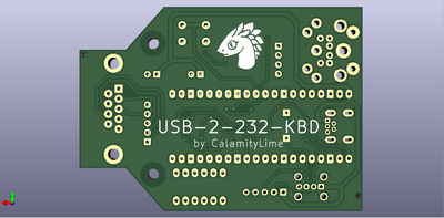

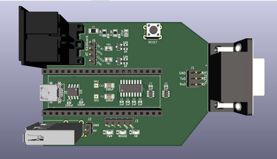

​Alrighty, today's mission is going to be making the back of the board look nicer.
​Silkscreen, move traces around to look nicer, teardrops, some filleting maybe.
​Outside of the name of the thing, does anyone have a suggestion for something to write into the silkscreen or even the ground flood fill?
Be Happy, it's only going to get worse.
- Projects
Limes Strange 3D models
USB-2-232
Reply 111 of 231, by CalamityLime
​There we go.
​Moved some traces around to keep vias away from the silk screen and to try to make them look nice.
​The 5v power got itself a nice thicc trace, I don't think it needs it but I think it looks nice.

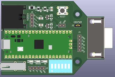

​I also went ahead and renamed the project from USB-2-232-AT to USB-2-232-KBD
Hopefully it can be made support both AT and XT Keyboards, I haven't looked too deep into that topic and ultimately I lack the hardware to test it but to my understanding both standards are fairly similar with XT not having the same back and forth conversation that AT has.
​-Lime

Reply 112 of 231, by Sphere478
CalamityLime wrote on 2022-05-19, 12:27:
​Alrighty, today's mission is going to be making the back of the board look nicer. ​Silkscreen, move traces around to look nicer […]
Write “Sphere was here”
Labeling the port functions and explaining them seems standard.

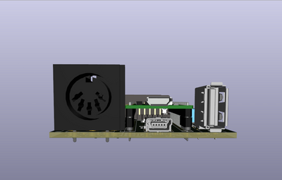

Reply 114 of 231, by CalamityLime
Sphere478 wrote on 2022-05-19, 20:46:
The front of the board has a bit more information than the back of it but today's mission was making the back of it look decent.
The front is fairly dense with bits but I put as much on the silk as I could.

Reply 115 of 231, by CalamityLime
Sphere478 wrote on 2022-05-19, 20:48:
This would be pretty handy when playing with win 3.11
I'm not sure I get what you mean, could you elaborate?

Reply 117 of 231, by matze79
It adapts usb keyboard or usb mouse to either DIN AT Keyboard or RS232 Serial Microsoft Mouse or maybe both at same time
Reply 118 of 231, by CalamityLime
Sphere478 wrote on 2022-05-19, 21:21:
Win 3.11 and usb don’t play well. 😀
I am understanding that this adapts usb, din, ps2 HIDs to serial right? And vice versa?
I guess I should ask what are all the possible combinations?
The original USB-2-232 adapts a USB mouse to a serial mouse, supporting MS 2 button, Logitech 3 button and MS wheel mouse protocols.
It has some extra bells and whistles to make it nicer to use and I might go back to the mouse side of things in time to add Mouse Systems, Sun and maybe some Logitech C7 extensions.
Currently I am tired of making that and I won't add those for a while. I'll only update the mouse side of things if something is currently broken.
The aim of the KBD variant is to adapt USB keyboards to DIN AT/ps2 and as a stretch goal XT.
General idea is that you plug the device into your serial port, use a modified midi cable to connect it to the Keyboard DIN also. You can power it from a USB charger or from the keyboard din port, you can toggle that with a Jumper.
Then you could use the USB port on the board to connect it to a USB hub, mouse, keyboard or KVM.
While adding a USB hub to the board would give a visual indicator of "You can plug in 2 devices" I feel like the added cost and complexity wouldn't be worth it unless the pico has issues with hub compatibility that I haven't ran into myself.
The USB-2-232, due to a feature request, does has a serial terminal that you can access to configure the device. You can access it in DOS with Kermit over the same com port you're using for the mouse OR over the unused uart of the pi pico.
That's where the mini B port comes into play. The ch340n is hooked up to the previously unused UART of the PICO and you can connect it to your modern win10 machine, it'll appear as a COM port and you can access the serial terminal using PUTTY (or whatever) with hardcoded settings. This would be very handy if you want to configure the adapter on it's own, while playing a game on your retro PC (to get the feel right) or if you pick settings that don't work with your retro PC's serial port.
matze79 wrote on 2022-05-19, 21:41:
The hope is that it'll be able to do both at the same time with the use of a hub or KVM. I won't know how achievable that is until I get coding something better than my proof of concept.
That's why I'm making the board, my breadboard worked for proof of concept but something keeps shorting on it and burning the AND gate that I'm using as a buffer. So I don't trust it really.
One last hope is that the firmware will be compatible with both USB-2-232 and USB-2-232-KBD, regardless of the difference in pinouts. The USB-2-232 just won't have the hardware for the keyboard.
I have a config file in the firmware that sets which pins of the pico do what. I've also been using that file as a pseudo manual.
I hope that helps explain things.

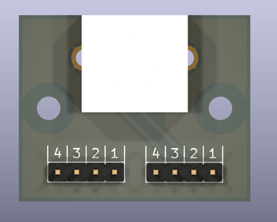

Reply 119 of 231, by CalamityLime
For a bit of fun and to make the most out of ordering from JLC, I made a board to hold a PS/2 port in a serial port mount on my at case.
The board holds the ps2 port and a 3d printed bracket holds the board to the case.
There's probably better things out there so I'm not going to bother releasing it. This is mostly to try panellising.
-Lime
