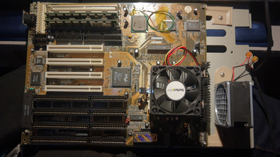

Reply 163 of 240, by CalamityLime
I reprinted the fan mount with an edit and i printed another mount for the upper left hand corner.
It may be a bit silly but honestly so few holes lined up that the weight of the VRM heatsinks pushed down enough to make the left side of the board touch the backplate.
Thank goodness for my 3d printer.
I also hook the fans up to an old Nzxt fan controller i have kicking around from the mid 2000s. Sliders on fan controllers and zalman CPU coolers really define the era of the core 2 for me.
I still remember seeing alien ware machine for the first time and it was before dell took them over and made them complete trash.
I also got a strange cooler master heatsink from that time that i can't find much information about. I found hints saying that it came with a case and very few were made. I'll have to take pictures of it at some point, maybe someone knows what it is.

Reply 164 of 240, by Sphere478
Socket 7 coolers usually vent out the clip side. May wanna think about changing heatsinks

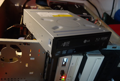

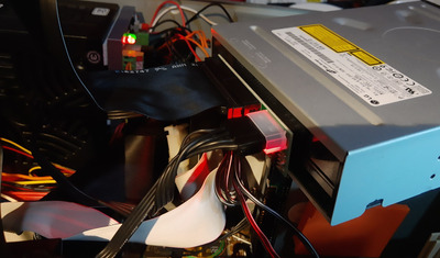

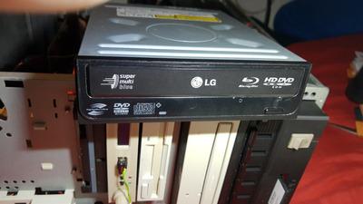

Reply 166 of 240, by CalamityLime
Amazingly strapping a hd-dvd drive to the socket 7 didn't work 😂
Worth a try at least.

Reply 167 of 240, by Sphere478
If it was sata that’s why it didn’t work.

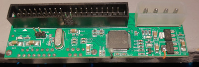

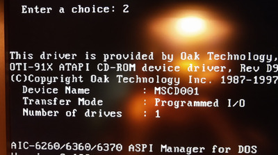

Reply 168 of 240, by CalamityLime
Hey hey hey, the computer even boots to it!
I modded a a m/s select jumper onto my sata to ide, I also switched to using the correct setting since previously I had both the CF card and sata to ide set to master
EDIT: the spot where I put the jumper headers was previously an empty jumper header wired to a pin on the MCU labelled PORn, power on reset, with an innocent n which is used as a remote power switch.
I cut the trace to the PORn and wired it to mssel but before realising that I need a pull up resistor to operating voltage which comes from the 1.8v regulator.
So leave high for slave and pull low with the jumper for master.
I don't know why the board decided not to include that by default.

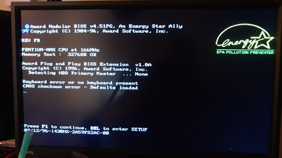

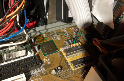

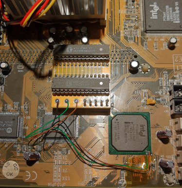

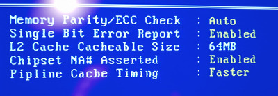

Reply 169 of 240, by CalamityLime
The tag ram mod didn't work.
I tried both with the resistor in place and removed. The pc still boots but the cache value doesn't change
EDIT: Looking at images of other peoples boards I noticed they can select the level 2 cache size option but I can't. I think I'll try modding the bios to let me click that option. I thought it was just a heads up display or something.

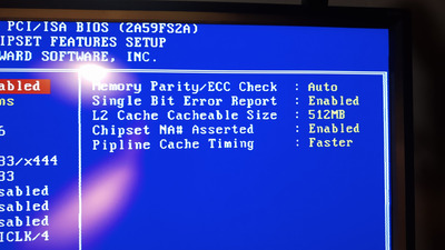

Reply 172 of 240, by CalamityLime
I modded the bios in modbin, set the l2 cache to 512, rebooted and it posted.
Does that mean that it worked?
EDIT: it would be awesome if it worked

Reply 173 of 240, by bofh.fromhell
CalamityLime wrote on 2022-06-30, 21:34:
Cachechk will tell!

Reply 175 of 240, by majestyk
"Cachechk" and other tools won´t tell you the cacheable RAM size for L1 and L2. You need "ctcm7" for that. But as long as you have only 64 MB RAM populated it will just tell you the cacheable size is 64MB.
You´ll have to go for more RAM!

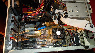

Reply 177 of 240, by CalamityLime
CF to ide adapter
NZXT fan controller
HD-DVD rom drive
3.5inch floppy
limited edition SFRKC30 Gotek with STM32F105, only 100 exist
SD to IDE in a very user unfriendly position.
Now there's a combination.
A very stupid combination but knowing that this thing can boot from the hd-dvd rom drive just makes me smile. Unfortunately the blue laser in the drive is dead so no booting dos from a blu-ray disk today.

Reply 178 of 240, by majestyk
The 430HX MCH only knows the two operational modes "(reduced) cacheable area 64MB" and "enhanced cacheable area 512MB".
If ctcm7 confirms a 96MB cacheable area I think we´re safe to say the MCH is in enhanced mode. It probably wouldn´t enter this mode if not all 3 additional Tag-IO lines were active.
Assumed BIOS sets the correct registers...
Was the 64/512 switch a hidden option you just enabled in Modbin or did you have to create it?
