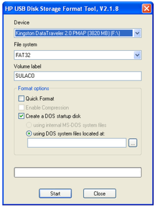

Edit: There also was that HP USB utility.
It could create a bootable USB stick. It predates Rufus by many years.
Maybe it works for you. Good luck!

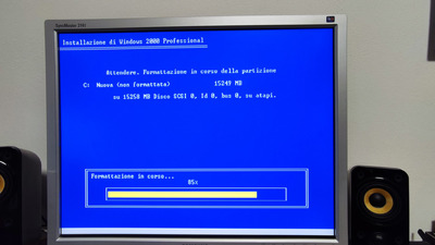

Finally I returned in this project.
After a various trying, I found a way to make install Windows 2000.
I supply a CD-ROM of another computer and connecting the IDE cable to this client.
Finally I can boot from CD-ROM, I was happy, I tried to install Win2000 and the procedure seems went fine. It formatted the 16GB Compact FLash, it copied all the files, but FUCK, then it reboots it stucks with a cursor on the screen.
I waited a lot, but nothing happens. I am really getting mad with this stupid Thin Client, I wanted to put there Win2000 or Win XP and use this VIA C3 1,0ghz processor, but nothing seems to work when I use that CF.
It can be formatted, I can copy files too..but in this fucking client it seems not to work.
Anyway the Win2000 setup formatted correctly it, and it copied correctly files.
I really don't know what to think, I don't know what to do.
Can be a hardware problem probably with the bus, I don't know.

    with the Win2000 CD installation continue until the end

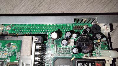

    some other codes

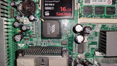

    the CF from Sandisk (correctly recognized from the BIOS)

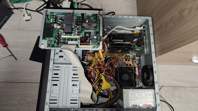

    the think client with the CD-ROM from another PC
