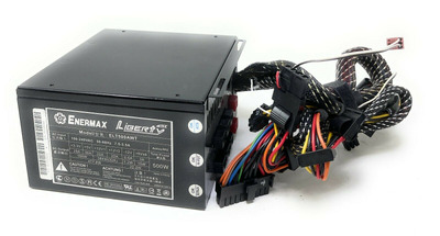

Reply 3 of 13, by Repo Man11
I use one of these with my 8KRA2+:
"A lot of times when you first start out on a project you think, This is never going to be finished. But then it is, and you think, Wow, it wasn't even worth it." - Jack Handey

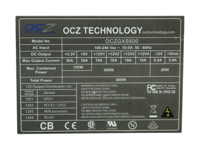

Reply 4 of 13, by Repo Man11
Here's another that should work.

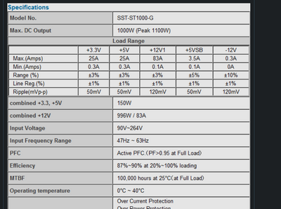

Reply 12 of 13, by acl
To avoid having to store 10+ cases, i have a bunch of "fixed" configs, plus a test bench where i assemble the other configs when i want to use one.
On this bench, i'm using the same PSU for everything from Socket 7 to S1366 : SilverStone SST-ST1000G https://www.pccasegear.com/products/16483/sil … 0w-gold-st1000g
I bought it 2nd hand for ~45/50€ (but with one missing cable i think)
I never had issues with my AthlonXP3200+/MSI K7N2 (but i don't know if +5/25A is enough at full load)

Reply 13 of 13, by Repo Man11
acl wrote on 2022-08-03, 12:56:
To avoid having to store 10+ cases, i have a bunch of "fixed" configs, plus a test bench where i assemble the other configs when […]
Like many of the tail end Socket 462 motherboards, the K7N2 has a P4 connector, so a strong +5 isn't important in the way it is with the Socket 462 boards that don't have the P4.
