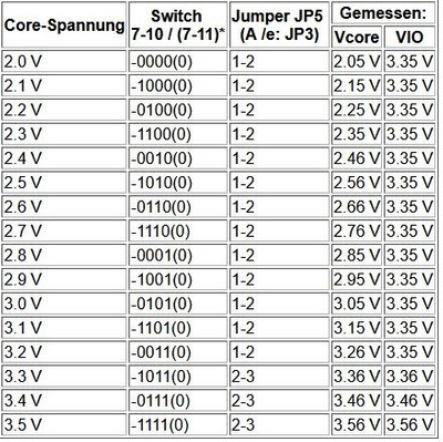

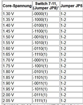

Reply 26 of 42, by majestyk
The DFI K6XV3+/66 can go down as far as 1.3V
32.43 KiB
334 views
The older versions (without 66) end at 2.0V:
76.19 KiB
328 views

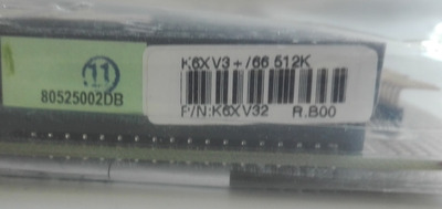

Reply 32 of 42, by haker120
Ok, so just update to the newest 1231 or patched for K6XV3+/66 from @Chkcpu? I didn't have time for testing it but bought from trusted seller and I'm still waiting for processors from the USA. 😀 I'm worried to not brick it.
Why print on mobo says K6XV3+ rev: B and not K6XV3+/66? Weird mobo or made before /66 or what? 😁
Reply 33 of 42, by majestyk
The southbridge (the VIA chip besides the PCI-slots) makes the difference between ATA 66 and ATA 33.
Your mainboard is Revision B, there was a Revision B2 later. Both are 100% ATA66.
The printing in the silkscreening mustn´t be taken too seriously. It also says "Made in Taiwan" that wasn´t allowed and manufacturers had to put a "R.O.C." (Republic Of China) sticker onto it.
Sometimes there were additional small stickers with a different printed text or just for the revision number put onto or besides the silkscreen writing.
The sticker on the bottom ISA slot has the last say here.
There´s some detailed information on this (German) site:
https://www.udo-richter.de/DFI/

haker120 wrote on 2022-08-06, 11:37:
Good question.
I only have three of the B2 revision (two 512KB and one 1MB) and they all have "K6XV3+/66" on them.
Maybe they changed the imprint, because people were bricking their boards with the wrong BIOS?
