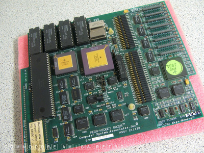

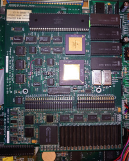

i am not sure what package type it is and i thought it was 32 pin dip packages
Sorry, this a picture of the accelerator (not my one but same board)
I can add a picture of my one tonight if it needed

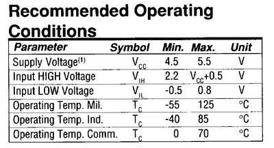

Looking at the datasheet for original chips, this what say for voltage (which is all greek to me) and the pinout
Reply 7 of 30, by dionb
"Supply Voltage" is the relevant value here. This says it needs 5VDC+-10%.
So any similar 5V chip would work fine. If a chip indicates "Min 2.97 Max 3.63" then it's a 3.3V part and might get fried. So long as the Max is 5.5V it will be fine.

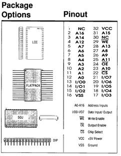

ok looks the chip in link above (nec chip) might work as the pinout is mostly the same as original with some little different's and the "operating voltage" is 4.5 - 5.5
here is pic
Reply 9 of 30, by dionb
The devil is in the details. "Little differences" could mean the difference between working and smoking.
Smoking isn't going to happen here, Vcc corresponds, as does Vss = GND.
Next the I/O lines are labeled 0-7 on the Inova datasheet but 1-8 on the NEC one. That's probably more naming convention than anything else.
What I'm worried about are pins 22 and 30. On the NEC chip they're labeled Chip Enable 1 and 2, but on the Inova chip 22 is Chip Select and 30 is NC. I'm not the world's greatest authority here, but Chip Select/Enable allows you to wire two chips in parallel and use this/these lines to determine which one is used. And it sounds like they're implemented in a different way. If your card uses this functionality, the NEC chip probably won't work.
But again, I know about the principle, not the details. Maybe someone with more relevant knowledge can indicate whether CE1/2 is the same as CS/NC.

Reply 12 of 30, by mkarcher
dionb wrote on 2023-02-07, 14:17:
Not just "more" a naming convention, it is only a naming convention. That's perfectly fine.
It's not the same, but it's not a problem, too. The chip is only enabled if all chip select inputs are at the level that activates the chip. Pin 22 is /CE1 on the NEC chip, and /CS on the Innova chip. (The bar over CS at the Innova chip means the same as the slash before CE on the NEC chip: This signal is active low. Because the slash is representable in plain text, I continue to write /CS instead of "CS with a bar above"). "Active low" means that Pin 22 needs to be at a voltage below 0.8V for the chip to be enabled. That's the case for both the NEC and the Innova chip. That's good. Furthermore, /CS is the only way that chip can be enabled/disabled, so if the card uses that functionality at all, it will use Pin 22. Now the NEC chip has a second chip enable signal, called CE2, without a slash in front of it. This signal needs be above 2.5V for the chip to be enabled. We now that the accelerator card doesn't require the functionality of CE2. There are two likely ways the accelerator card is designed: Either, it just doesn't connect pin 30, or the designers of that card knew about the NEC pinout variant (which is common, as is the Innova variant), and already connected that pin to +5V. It is unlikely that Pin 30 is connected to anything else, if that socket is meant to be used with 128K x 8 SRAM chips.
So you should check whether there is conductivity between pin 30 (CE2) and pin 32 (+5V). If yes, the NEC chip will work out-of-the-box. If not, check whether pin 30 is connected to ground (extremely unlikely, but better safe than sorry). If pin 30 is neither connected to ground nor to +5V, just add a small bodge wire to pull pin 30 high, and your card will be "NEC compatible".

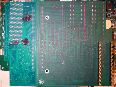

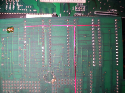

When I having a look at the underside of the accelerator, I noticed (I forgot was there as I bought it years ago) that there wires going from and to what I think is pin 30 across all four SRAM sockets and down wire going down to a pin on the pga (which i am assuming that is ground) and I remember the person I bought this from done some repair work on it year and years ago, pic attached

Reply 17 of 30, by Robhalfordfan
ediflorianUS wrote on 2023-02-08, 09:21:
could the repair job be the main problem?
it could be but when looking for pcb traces at pin 30 - looks like there isn't and the wires gives it the traces and pulling that pin high - correct me if i am wrong
Reply 18 of 30, by mkarcher
Robhalfordfan wrote on 2023-02-08, 09:31:
The bodge wire puts all pins 30 in parallel. It also connects these pins to a pin of the 68882. According the data sheet, that is the SIZE pin, and you see a trace to the A0 pin. If the 68882 is supposed to operate in 32-bit mode (which it should on the mega-midget racer to match the 68EC030), both A0 and SIZE are supposed to be conncted to +5V. This means that the extra wire provides the required level at pin 30, and the NEC chip should work without any problems. It's surprising that they didn't just bridge pin 32 to pin 30, but probably they did it the way it's done because that way allows clean looking straight wires.
Reply 19 of 30, by Robhalfordfan
