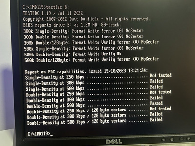

I confirm the drive spins up and tries to read the disk.
Due to some issues with the test motherboard I had to switch the DOS unit for the next test.
I tried the "format B: /U" command several times in 360k mode using a 1.2M but the drive stays "not ready"
Unfortunately I do not have a magnet available yet.
Something interesting using TESTFDC, the format / write / verify test was successful in 500kbps double-density.

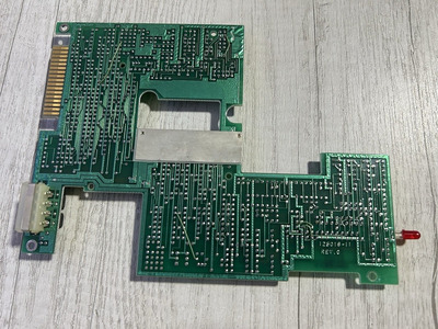

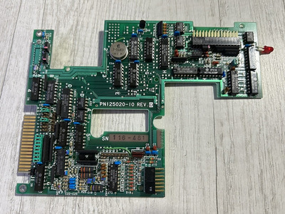

Reply 27 of 38, by Vendest
Deunan wrote on 2023-10-20, 10:42:
If the schematic is correct and this signal indeed conditions the output of INDEX via an AND gate then sadly yes, it cannot be switched to DC. Some ICs offer such selection (between RDY and DC) via jumpers next to the IC, not always directly on the output line itself. But it's not possible in this case.
Well, the good news is you can work around this problem to some extent. In DOS 5+ there is CONFIG.SYS setting called DRIVPARM that can be used to override some floppy drive settings. It can be used to disable DC and force DOS to re-read the floppy directory structure on each access - obviously this will have performance penalty but it works (this is how 360k drives operate, that's why I wanted to test this). It should work even without cutting the signal trace but will not allow you booting from this drive (as the setting is only applied once CONFIG.SYS is loaded and parsed).
The schematic is for a different model of Y-E DATA drive but shows the same ICs and pinout.
DRIVPARM works great only after cutting the RDY signal located on the permanent jumper. I have added a pin header in case I ever need to use the RDY signal.
Posting back and front pictures of the control board for reference.
Thanks a lot for your help, the drive can now be used in both DOS mode and Win98.
