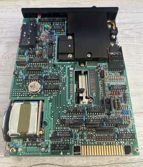

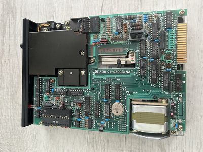

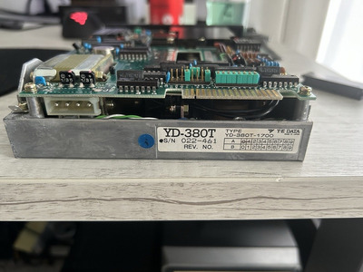

Hi, I recently acquired a floppy drive type YD-380T-1700 from Japan which I cannot get to work on my PC.
The initial intent was to set it as drive B, 1.2MB and was set in the Bios accordingly.
I could not find any documentation about this drive, 1710 version is more documented.
Basically the drive does not seem to react when connected to the motherboard.
I've confirmed a few operations, the motor-drive spindles when a disk is inserted and stops immediately when the lock is actuated.
The solenoid seems to work as I can see and hear the latch. it is also supplied by +12vdc (There is 90 ohm resistance thru the coil which seems healthy).
The stepper motor is able to retract the carriage back to its initial position if I push it away manually.
Other than that the drive does not react and the red led stays off unless a jumper is removed.
I moved some jumpers around, the DS0-3 selection and the 150 ohm terminations.
I am thinking the drive might need a non standard PC controller and was wondering if someone on the forum knows about this drive?

Reply 4 of 38, by Horun
It is a 96tpi 1.2Mb floppy drive, some model 380's cannot read 360k floppies because they are locked single speed 360 rpm, not dual speed. Make sure in bios you have it set as a 1.2Mb...
Reply 5 of 38, by Grem Five
I have seen YD-380 but never a YD-380T.
I would have to check but I think I have a YD-380 that works on IBM PC compatible machines.

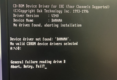

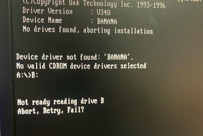

Boot in DOS 6.22 from drive A, trying to access drive B "Not ready". The comment seems to appear almost immediately while the drive is getting ready.
This is where I tweaked the jumpers, tried different floppy disks and cables.
I have no clues how to get past this issue.

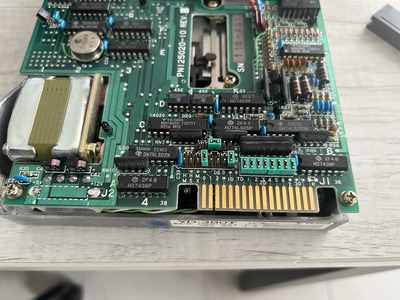

Posting a picture of the final jumper settings that works for me.
Reply 12 of 38, by Deunan
Vendest wrote on 2023-10-15, 09:24:
Some progress after further testing in Win98, the drive is now accessible.
But it is still not accessible in DOS 6.22 and DOS mode "not ready"
I find it odd that you need to remove the pull-up/terminator pack jumper. Can you measure the resistance of the pull-up pack on that drive? Note, you need to measure it vs +5V line, not GND. In fact it would be best to make sure all the inputs to the drive are properly terminated.
In general the not ready error is either due to READY and DISK CHANGE singnals being output wrong, or some issue with track zero sensor but that would also trip Greaseweazle right away, as well as Win98. Since this setup kinda works with the terminator jumper removed I assume you have another drive (as A:) on the cable as well, and that one is properly terminated? Because the issue could be with the terminator pack, or a stuck output, on the other drive.
Try connecting this drive as A: at the end of the cable, and no other floppy drives. Reconfigure BIOS, possibly also close the jumper for termination. Does this work? If not set the drive to 360k in BIOS and try again, did anything change? It might not read floppies but does it try now or error out right away?

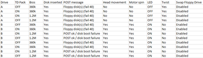

Thanks again for your advice and useful information, I have done additional testing based on your recommendations and more.
With the drive connected on another motherboard thru a cable with a single connector and twist, drive set as A: with and without the pull-up resistor pack and set as 360k then 1.2m in bios. The drive does not budge at all, fails during POST.
Then I tried with 3 different 3.5" drive as A and the 5.25" as B , with and without pull-ups. DOS reported "extended error 21" which seems to be similar to "not ready" error.
Also tried to boot DOS from 5.25" drive by enabling drive swap in Bios. The disk was not detected as bootable.
I then decided to check the drive with a dedicated DOS/Win3.11 unit that I use for gaming and disk imaging. The unit is equipped with a modern ISA FDC card supporting 4 drives (Quad-Flop) and currently working fine with 3 drives 1.44m, 1.2m and 360k.
The drive behaves the same in DOS "not ready" and Win3.11 "no disk detected"
Moving back to the Win98 unit, the drive set as B still works in Win98 with or without pull-ups. I must admit that that was the initial intent to have a 1.2m available in my Win98 unit, just that it bugs me that the drive will not be available in DOS mode.
The resistor pack is not socketed unfortunately but I could attempt to replace it with a 1k.
Reply 16 of 38, by Deunan
Vendest wrote on 2023-10-16, 15:46:
So, it fails POST both with and without the TD jumper pack? And that's both when set as 1.2M and as 360k? Is the error something like "FDC failure" or something else?
Can you test it (TD jumper pack installed, drive set as 360k, then 1.2M) with a floppy already inserted at power-on? Does it still fail the same way and is there any difference at all between 1.2M and 360k settings - like head movement or attempt to spin on one setting but not the other?
I have 3 theories but 2 of them are very unlikely as the drive does work in Win98 and with Greaseweazle. So it's not track 0 sensor issue and most likely not that INUSE signal is required but missing. By the way can you check where pin 4 of the floppy connector goes to, it's connected to the 150 ohm pull-up so must be used (though optional). Is it connected to the INU jumper perhaps?

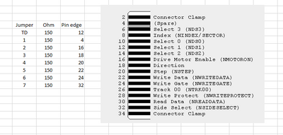

Please check were pin 34 is connected. I think I see a missing jumper marked "R" nearby, is it permanently open or closed (copper trace connecting the pads)? Some chances are this particular drive was never meant to be used in a typical PC and there is no way to configure #34 to be DC instead of RDY, or perhaps it's not connected at all.
EDIT: BTW for a PC you should use this pinout rather than Shugart one: http://www.interfacebus.com/PC_Floppy_Drive_PinOut.html
Reply 17 of 38, by Vendest
Deunan wrote on 2023-10-16, 16:39:
So, it fails POST both with and without the TD jumper pack? And that's both when set as 1.2M and as 360k? Is the error something […]
Motherboard used for test TMC TI5VG+
Pin 4 goes to TD1 pull-up, INU and HL.
Pin 34 connects to jumper/trace R which is closed and connects to the HD7438P logic chip.
The drive is not detected in 360k mode.

- Seek floppy drive disabled in bios
- Set to 360k
- Tried with one 360k disk formatted in a 48 tpi drive and one 1.2M formatted as 360k in a 96 tpi drive.
After booting into DOS, it gives an error "General failure reading drive B"
It is a common failure I'd get on my DOS PC when a badly formatted disk is used in the drive.
I set the drive back to 1.2M again, then the usual error "Not ready reading drive B" was back.
