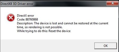

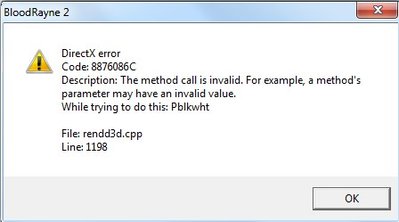

Bloodrayne crashes with this error message:
19.05 KiB
4001 views
and part 2 with this one:
21.78 KiB
3996 views
