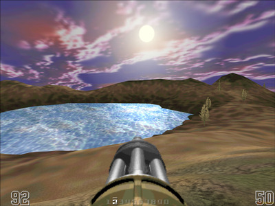

Reply 169 of 276, by ZellSF
RaVeN-05 wrote on 2020-02-09, 19:37:
Hello! found that Z.A.R game d3d version can't work with dgVoodoo it says "Z.A.R. Error 3D hardware NOT found."
without it can be played in Direct3D using 800x600x32 resolution mode.
Am I missing something?:
377.69 KiB
3053 views
Resolution forcing, MSAA and AF seem to work too. This is the 1.03 patch, which is the only D3D version I could find.

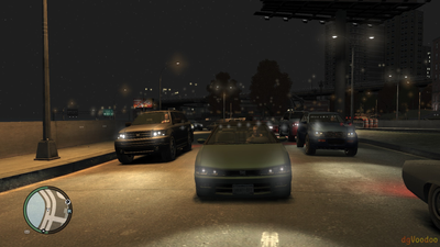

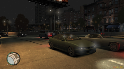

Hello Dege, i tried Version 2.63.1 with GTA IV and got very good Frametimes but a bad Glitch with the Engine. All Lights are visible all the time. Means i see car lights behind the wall 😀
See Screenshots:
    1.7 MiB
    2833 views
    1.45 MiB
    2833 views

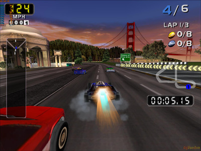

Reply 173 of 276, by Daninthemix
Just wondering why DgVoodoo doesn't render at high resolution on San Francisco Rush 2049:
[Mod: LINK REMOVED]
It does hook and give me a full screen window, but it's not increasing the internal resolution of 3D within the game.
Reply 174 of 276, by ZellSF
Daninthemix wrote on 2020-03-21, 14:54:
1) Don't link to illegal software distribution. It places the forum you're asking for help (VOGONS) at increased risk of legal problems. Causing problems for people you want help from is a bad idea.
2) If you've downloaded the game from that link, you really should stop downloading software from so sketchy sources. Unless this is a gaming only computer, downloading stuff from Youtube seems like an excellent way to get ransomware / account stealing software on your computer.
3) A legit version definitely works:
257.34 KiB
2764 views
Make sure you're running it from the launcher, or running it with -f.
There's a problem with the Midway logos, but it doesn't seem to be caused by dgVoodoo, dgVoodoo just makes it worse (they're supposed to change to different images when rotating, but they just flicker).
