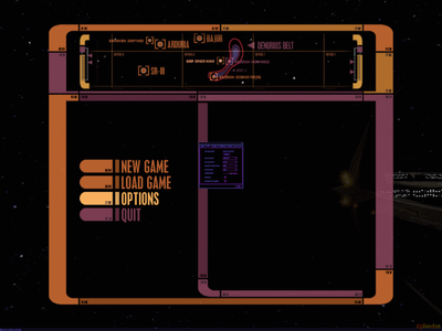

Hi,
To my knowledge there are so far two custom DLLs that allow you to overcome the restriction of the 2048x2048 maximum resolution specified by Direct3D 7 (or would it technically be DirectDraw [7]..?), therefore enabling you to play games from around 2000 at resolutions such as 2560x1440, or even ultrawide 3440x1440. Without such a fix the game will invariably crash.
The first is jackfuste's DLL :
https://www.wsgf.org/phpBB3/viewtopic.php?f=6 … tart=30#p155982
The other one is UCyborg's D3D Resolution Hack:
https://github.com/UCyborg/LegacyD3DResolutionHack/releases
However, these custom DLLs seem to conflict with dgVoodoo's own DLLs, you can either use the resolution fix or dgVoodoo2. Unfortunately, I need the wrapping functionality of dgVoodoo to use ReShade (which needs D3D9 or later).
Is there a way to use both? Or another wrapper compatible with the fixed DLLs mentioned above?

Reply 3 of 12, by brazzjazz
The game is Star Trek Deep Space Nine: The Fallen. With dgVoodoo (2.63.2), any resolution higher than 2048 px will give me a window of 2048 pixels' width which will crash after a few seconds. That happens no matter whether I launch it with the resolution completely unforced, forced WITH the application controlling fullscreen / windowed state (checked) or forced WITHOUT the application controlling fullscreen / windowed state (unchecked).The same happens in Clive Barker's Undying, for instance. I removed the D3DIM700.DLL before testing of course, as its presence alone in combination with dgVoodoo would have crashed the game by itself.
I'm not sure how I would properly set up the ASI loader, at least when I use D3DIM700.DLL as an .ASI it will not work. Or am I supposed to load a dgVoodoo DLL through ASI loader and keep D3DIM700.DLL as is? Is there a correct sequence? Or doesn't the resolution hack DLL conflict with a dgVoodoo DLL anyway..?

Reply 4 of 12, by ZellSF
brazzjazz wrote on 2020-06-05, 12:12:
Don't load D3DIM700.DLL. I've already said this; dgVoodoo does not implement the limit that fix tries to work around. If you're having an issue with this game at larger resolutions in dgVoodoo, it's something else.
I would reinstall the game entirely and make sure you're using a clean dgVoodoo config.

Reply 5 of 12, by Dege
Yes, dgVoodoo doesn't have the max VGA resolution (2048x1536) limit.
Undying, for example, works at 2560x1440 for me purely through dgVoodoo, if I set the fullscreen resolution to 2560x1440 in the proper ini file (maybe System.ini) of the game (it generally works for every Unreal engine game).
I also remember having some crashes though at some points but when I debugged them I couldn't see anything to do with dgVoodoo (rather the engine itself), and I didn't care about it because 2560x1440 isn't amongst the supported resolutions in the game options menu after all.
Btw, does the dbg version of dgVoodoo say something useful before crashing? Maybe the amount of VRAM in dgVoodoo.conf is set to extremely low or sg like that.
Reply 6 of 12, by brazzjazz
Dege wrote on 2020-06-05, 14:06:
Made a new installation, removed any dgVoodoo settings to the folder, and ran installed debug version of dgVoodoo. Still crashes, and I got this as debug:
Log: Log file open, 06/05/20 17:10:50

Log: Bound to D3DDrv.dll
Init: DirectDraw drivers detected:
Init: display (dgVoodoo DirectX Wrapper)
Init: \\.\DISPLAY1 (NVIDIA GeForce GTX 970)
Init: D3D Device: Supports system memory DMA blts
Log: D3D Device 65536K vram, 60416K free
Init: Unreal Tournament Direct3D support - internal revision 1.9b
Init: D3D Device: szDriver=dgVoodoo
Init: D3D Device: szDescription=dgVoodoo DirectX Wrapper
Init: D3D Device: wProduct=17479
Init: D3D Device: wVersion=2
Init: D3D Device: wSubVersion=63
Init: D3D Device: wBuild=2
Init: D3D Device: dwVendorId=0
Init: D3D Device: dwDeviceId=0
Init: D3D Device: dwSubSysId=0
Init: D3D Device: dwRevision=0
Init: Best-match display mode: 3440x1440x32 (Err=0)
Init: D3D Device: dwZbuffer depth: 32 bits.
Init: CreateSurface failed for Z (DDERR_OUTOFVIDEOMEMORY)
Log: 3d hardware initialization failed

Reply 8 of 12, by Dege
I cannot see any dgVoodoo-specific entry in the log, but anyway, you have the amount of VRAM set to 64MB which is too low for 4k:
Set it to 1024MB and let's see what happens.
Reply 9 of 12, by brazzjazz
I added the executable folder to dgVoodoo's settings, and it showed 256 MB there (so I assume that is what is used as default..?), but I changed the value to 1024. Now it works!
For a while I was fairly convinced that it had something to do with the resolution, as I've had the same problem with Clive Barker's Undying and the resolution. Now I'm gonna try the same method with that game as well.
Edit: out of curiosity, I set VRAM size to 256 MB, it runs as well. So somewhere dgVoodoo must have worked with 64 MB for some strange reason.
Thanks! 😀

Reply 11 of 12, by brazzjazz
ZellSF wrote on 2020-06-05, 17:45:
FYI you can't play Undying at higher ingame resolutions (it will crash at certain places). You need to select a lower resolution ingame and just force a higher one with dgVoodoo.
I'll give it a try, thanks.
BOW to the GTX 970 Master Race! 4 (read: 3.5) gigs of precious GDDR5 random-access memory will kick your sorry ass.
Specs: Intel Xeon E3-1231 v3, MSI GTX 970 @1454/3893 MHz, 16 GB DDR3-1600, Win10 x64 20H2
Reply 12 of 12, by brazzjazz
By the way, do you have an idea why the HUD shows no texture filtering on these higher resolutions? Would be nice to get it at least filtered, even if it is badly oversized etc.
