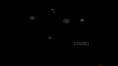

Reply 24 of 70, by tomba4
Hi,
I've been using dgVoodoo for demoscene watching, but since v2.76 (2.75.1 is OK) very few demos work correctly (e.g., textures are missing). I finally decided to check the debug logs and I see e.g.
"[dgVoodoo] WARNING: Direct3D8 (01BDAB20)::CheckDeviceFormat: Resource type D3DRTYPE_TEXTURE with format D3DFMT_R8G8B8 and usage (0) is not available on device type D3DDEVTYPE_HAL with adapter format D3DFMT_X8R8G8B8"
The example I used is "Mechanical Dreams" by Suspend (https://files.scene.org/view/parties/20 ... uspend.zip).
Is that warning a possible explanation for the issues? And is that something that could be fixed? (Note: the OS I'm running is 32bit Windows 7 on VMWare)
Reply 25 of 70, by Dege
Then that must be a VMWare problem. You can try to disable option DirectXExt\EnableSpecializedShaders for newer dgv versions, but as far as I remember Mechanical Dreams has its own vertex shaders so that option might not have any effect for that demo.
Btw, why not just running those demos natively? There's no point of using dgVoodoo in a VM (another graphics wrapping layer in the chain) and 99% of scene demos works fine with dgVoodoo on Win10 (I have a large collection of them, including MechD).
Btw, that WARNING message means nothing in practice, it's very common with every D3D8/9 stuffs, it only means the application is queried if a particular format for a given resource type is supported and it turns out to be not supported.
I might remove that in a later version, it was implemented for tracking down various games to see if any of them truly needs an unimplemented format.

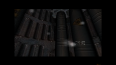

Reply 28 of 70, by tomba4
Dege wrote on 2022-03-20, 17:37:
Then, maybe 2.78.1 works with VMWare and DirectXExt\EnableSpecializedShaders enabled?
No, unfortunately doesn't work in 2.78.1 either. The result is that a lot graphics/effects are simply missing, e.g. in case of this demo at the beginning there's supposed to be a flashing background:

and instead there's just darkness:
