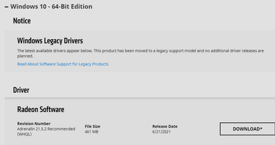

Reply 6 of 171, by gernumikus
Maybe for someone it will be important. On driver 18.6.1 with directx 11, there are no problems, no white textures are observed. You can safely use the latest versions of dgvoodoo with amd radeon (HD 7850 card and similar). I have checked dgvoodoo 2.75 and 2.75.1
Earlier drivers have problems with Vulkan, it is simply missing.
I know that it was said about white textures a long time ago, but drivers 21.5.2 are final and there will never be any updates for this card again. Maybe you could add a fix sometime? When will you have time?
Reply 7 of 171, by Dege

gernumikus wrote on 2021-07-23, 13:42:
I still have my HD7850 somewhere around but the machine I used it with is gone. Maybe if my current machine can handle 2 dGPU's then I can try it under Win10.
But, unfortunately it's not just about time. As you wrote, dgVoodoo works fine with older AMD drivers, so it's undoubtedly a driver bug. The worst scenario to debug is when the bug is not in your code.
The only help would be searching for the first dgVoodoo version where the thing broke, and experiment with it and a previous working version to see what change the driver doesn't like.
But I don't have the source for those old WIP versions... so the situation seems to be hopeless.
