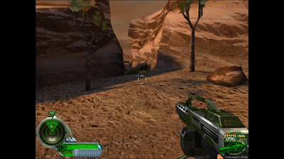

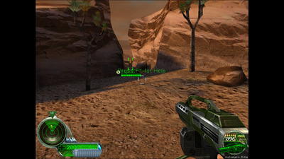

Reply 33 of 61, by KainXVIII
Here is comparison for Renegade truform btw (maybe i need to look somewhere else?)
338.42 KiB
1120 views
341.88 KiB
1120 views

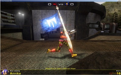

Reply 34 of 61, by RaVeN-05
And do not truform when angle between triangles is 0
i think it can prevent incorrect truforming of in hands flag.
424.22 KiB
1090 views
so cancelling 0 and 90 and 180 and 270 and 360 degrees possible to prevend incorrect looking items , like this flag

Reply 35 of 61, by Deffnator
RaVeN-05 wrote on 2021-09-13, 17:29:
And do not truform when angle between triangles is 0 i think it can prevent incorrect truforming of in hands flag. ut2004-flag.j […]
quake 1, 2 and hexen 2 has this issue, same goes to quake 3 if using mods, also some skins doesnt even work like stock crash or tank jr
https://imgur.com/a/TcV1qcC
