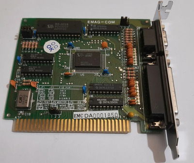

Reply 3 of 16, by Jo22
I don't mean to "purr oil in the fire", but.. Back in the day, XT class PCs with on-board graphics not too seldomly had a COLOR/MONO switch on the back (next to DE9 and RCA jack).
That way, they could either act as CGA compatible (home users who play games) and Hercules "MGA" compatible (professional users).
Same goes for many Hercules clone cards. They could be set to either COLOR/MONO via jumper.
So from my point of view, it could make sense to have a combined HGC/CGA test program.
Like a "CheckIt" utility, but for graphics cards. Anyway, it's just an opinion, no offense.
Edit: Found an example picture on the inter webs. ^^
    301.56 KiB
    509 views
Reply 4 of 16, by i386
Jo22 wrote on 2023-09-14, 06:50:
I don't mean to "purr oil in the fire", but.. Back in the day, XT class PCs with on-board graphics not too seldomly had a COLOR […]
Yes, you are right - I have combo CGA/HGC card and also native CGA card with "snow".
I wrote this program as combined CGA/MDA/HGC test (in first releases only CGA). I made
all compilations and testing on may 286 and XT boards
Thanks, very similar to my own combo card, SARC chipset!

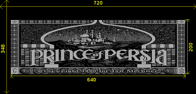

Reply 5 of 16, by Grzyb
i386 wrote on 2023-09-14, 06:40:
- 640x300 graphics test (as used for CGA emulation)
- 640x400 graphics test
- I do not understand, these modes is not CGA compatible...
640x300 is commonly used by CGA emulation software running on Hercules.
Basically, there are three approaches for CGA emulation on Hercules:
  • use 640x200 mode - same video memory layout as in CGA, but uses only a small part of the screen area
  • use 640x300 mode - uses most of the screen area, but every third scanline is left empty
  • use 640x300 mode, and copy a part of the video memory to fill the empty scanlines - uses most of the screen area, no empty scanlines, but the copy operation may slow things down

So, the emulation modes woud be:
  • 640 x 200, 2 banks, 67.8 Hz
  • 640 x 300, 3 banks, 50 Hz
  • as above, plus copy bank 2 to bank 3
I think there's also yet another approach, but not used by stand-alone emulators, rather by games with "native" Hercules support, see eg. Prince of Persia...

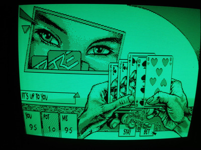

The game Teenage Queen, a poker game, seems to use two sets of graphics only.
https://www.mobygames.com/game/6224/teenage-queen/specs/dos/
The EGA one at 320x200 16c and and MGA one at 640x200 mono (partially redrawn by hand).
The mono graphics are used for both CGA and Hercules (aka HGC aka MGA).
So the Hercules card is being asked to handle CGA graphics, as well.
The higher width is used for dithering effects, I think.
Anyway, the outcome is very crisp, but also very compressed and doesn't do Hercules justice, I think.

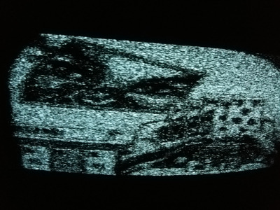

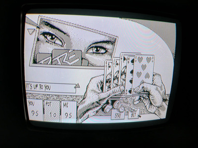

In short, it makes user wish to play on an 1970s portable TV via RF connection instead.
Which isn't impossible considering the mono ouput via RCA on many XT class PCs.
All it needs is an external RF modulator box which takes a composite signal and outputs it on VHF/UHF TV bands.
    699.74 KiB
    206 views
    Game on Color TV (via CGA mono RCA)
    517.34 KiB
    206 views
    Game on old b/w TV, via RF modulator. Not perfectly stable here, but dithering works. ;)
