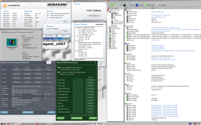

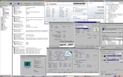

Reply 9 of 14, by agent_x007
Basics :
You can use 512MB PCI-e GPU on Windows 98 SE (but only if it's alone, dual GPU config will not work if either card has 512MB of VRAM).
You can install over 1GB of RAM but only IF you added before mentioned tweaks to system.ini, and use himemx.
317.88 KiB
2036 views
You will not be able to use over ~1,5GB of RAM if you have NVdia geforce 7800/7900 series card* , because both official and non-official NV drivers simply "give up" with that kind of system memory with Win98 OS (maybe 2GB would be possible with ATI GPU... I'm not sure because I didn't tested it).
Also, himemx/config.sys/system.ini tweaks, will not fix this problem in NV GPUs case.
*did not tested this with 7600/730 series or older 6000 series card
I only manage to bypass this problem with rloew's Win98 RAM patch (mentioned before) : LINK
Here's result :
473.35 KiB
2036 views
My experience with Win98 on above Core i7 980X setup : LINK
PS. system.ini tweaks I used :
[386Enh]
MaxPhysPage=48000
MinSPs=16
ConservativeSwapfileUsage=1
DMABufferSize=64
[vcache]
MaxFileCache=65535
ChunkSize=1024
^Source for above tweaks : LINK
Good luck 😀
