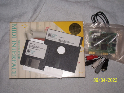

Reply 2 of 7, by Cuttoon
My CMS-401-II card came with Cakewalk 5.0.
379.97 KiB
516 views
And, much to my surprise, the 3.5 floppy could still be read.
At least I could copy all files to the hard disk.
Image maker quit with an error message but that's probably insignificant.
I assume I'm not supposed to just attach the zip here but send me a PN if interested.

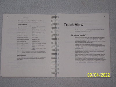

There also were 300 pages of manual, but those are somewhat less convenient to E-mail 😜
