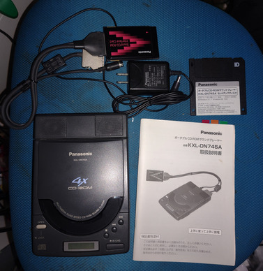

Won a KXL-DN745A on eBay (well, made an offer lower than the asking price) with basically all of the entails/trimmings:
I know it's Adlib support, which my NEC laptop really needs as it only has WSS, which is only SB and no FM.
I think this is a Japanese import model (the manual and diskette have the Japanese language on it).
That's a nice card. You can also try the Doom and Wold3D mods I mentioned above. They should work with both Adlib and digital sound.

Reply 421 of 579, by bjwil1991
Got the goodies yesterday afternoon.
Gotta translate the manual and the back of the drive to English.

Reply 433 of 579, by bjwil1991
I'm currently testing the KXL-DN745A on my Austin TFT 486 laptop (disabled the internal Sound card for testing purposes) and it gives me this:
Sound/CD-ROM Interface Card Driver Ver. 1.01 (960129)
for IBM Card Services 1.07 / 2.00
for SystemSoft Card Services 2.012.10
for Phoenix Card Services 2.00 / 2.01 / 2.10
All Rights Reserved, (C) 1995, 1996 KYUSHU MATSUSHITA ELECTRIC CO., LTD. (C)Copyright 1993, 1994, 1995 RATOC System Inc. Osaka Japan
IObase=0x 280, IRQ = 5, Socket = 0
Unable to get I/O Window.
Driver Unloaded.
CD-ROM Device Driver KMECD Ver. 1.71 (951102) All Rights Reserved, (C) 1994, 1995 KYUSHU MATSUSHITA ELECTRIC CO., LTD. (C) Copyright 1994, 1995 RATOC System Inc. Osaka Japan
ASPI Manager Mot Installed.
Driver Unloaded.
Device driver not found: 'PCMCIACD'.
No valid CDROM device drivers selected
I even tried the one for the CardTalk driver and that doesn't work either.
I'm using the English drivers since the Japanese one I cannot read at all (random letters and numbers).
Am I missing something here? In Windows for Workgroups 3.11, it doesn't work either.
Reply 434 of 579, by Bondi
Which driver do you use? IIRC aspis365.sys worked fine and did not require CS and SS. It is also possible to set port address and irq using /PORT= /INT= switches

Reply 435 of 579, by lolo799
bjwil1991 wrote on 2021-11-21, 10:57:
I'm currently testing the KXL-DN745A on my Austin TFT 486 laptop (disabled the internal Sound card for testing purposes) and it […]
Driver Unloaded.
Driver Unloaded.
Can you post your config.sys and autoexec.bat?
Reply 436 of 579, by bjwil1991
Bondi wrote on 2021-11-21, 11:16:
The ones I attempted to use are aspis365, aspismgr, and aspisdbk. All of which fail to initiate and my laptop uses the Databook CardTalk driver set. I changed the IRQs and port addresses to no avail, even leaving the thing blank does nothing.
Unfortunately, my NEC laptop died all of a sudden and cannot be used to test the drive out.
Reply 437 of 579, by lolo799
bjwil1991 wrote on 2021-11-21, 11:24:
Do you have SystemSoft Socket and Card Services loaded in order to use aspimgr.sys?
For aspisdbk, you need to exclude a memory range in the emm386 line in config.sys, it's detailed in the readme, and try using another IO address.
Reply 438 of 579, by Bondi
Did you see the readme file? It has a troubleshooting section related to Databook Cardtalk.
README.TXT

Reply 439 of 579, by bjwil1991
CONFIG.SYS:
DEVICE=C:\DOS\HIMEN.SYS
DEVICE=C:\DOS\MM386.EXE NOEMS X-CE00-CFFF
BUFFERS=40,0
FILES=40
DOS=UMB
LASTDRIVE=Z
FCBS=4,0
DEVICEHIGH L:1.12048 =C:\DOS\SETVER.EXE
DEVICE=C:\DOS\ANSI.SYS
DOS=HIGH
DEVICE=C:\PCMCIA\CARDSOCK.SYS
DEVICE=C:\PCMCIA\CTALKCS.EXE
DEVICEHIGH L:1,57856 =C:\PCMCIA\CARDTALK.SYS /A IOW=300-31F /MEM=CE00-CFFF
DEVICE=C:\MCDRM\ASPISDBK.SYS /PORT=280 /INT=5 /ADLIB /MEM=CE00
DEVICE=C:\MCDRM\KMECD.SYS /D:PCMCIACD
rem devICEHIGH=C:\PCMCIA\CTALKID.EXE
DEVICEHIGH L:1,4560 =C:\WINDOWS\IFSHLP.SYS
STACKS=32,256
DEVICE=C:\DOS\DRVSPACE.SYS /MOVE
And it gives me the error:
Databook CardTalk Not Loaded.
Driver Unloaded.
Reinstalling the drivers is out of the question since there aren't any installation programs on the hard drive (that came with the system) and on top of that, there aren't any drivers online for the PCMCIA slot.
My EXP CD-ROM drive works with it, however. Maybe I need to use the Japanese diskette to get it to work, eh?
