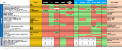

I've put together this chart with all information about all known PCMCIA (16 bit) sound cards and game port cards. This is the first draft, so feel free to comment and suggest changes. Question marks mean that either there is no info or it's unclear whether the function exists. Editable version is also available, PM me if you need it.
EDIT of 29.08.2023: added IBM CD-ROM, made minor changes
Latest version here https://docs.google.com/spreadsheets/d/181yzn … dit?usp=sharing
Great job!
melo wrote on 2021-01-26, 12:06:Great job!
Thanks!

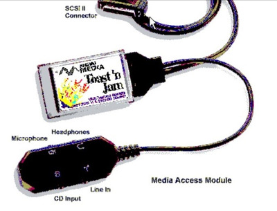

I probably should add the New Media Sound/SCSI ( it was renamed to Toast'n Jam) card as well, although it's identical to Wavjammer in the sound portion.
Here is the picture of the renamed/reworked one.
Nice list but next time please save as png (to avoid lossy jpg) and maybe with bigger zoom.
mt777 wrote on 2021-01-27, 21:00:Nice list but next time please save as png (to avoid lossy jpg) and maybe with bigger zoom.
Pdf of higher resolution is above.

The Media Vision PCMCIA sound card also provides MPU-401 (UART-mode) compatibility in DOS, for what it's worth.
Cloudschatze wrote on 2021-01-28, 19:23:Bondi wrote on 2021-01-26, 06:23:I've put together this chart with all information about all known PCMCIA (16 bit) sound cards and game port cards.
Thanks, noted.
