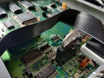

I've glad that I stumbled across this thread, as it's prompted me to check my SC-55.
I bought it a few years ago from Japan and it was listed as having "no battery"
However look what I found when I just opened it up...
The attachment SC-55 battery.jpg is no longer available
Thankfully it wasn't leaking, but I've removed it anyway.

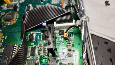

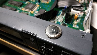

so shortly after getting my beige SC-55ST which doesn't have a battery I actually found a SC-55 mkI for a reasonable price as well and I'm glad I knew of this thread, thanks.
The attachment sc55_bat01.jpg is no longer available
is that white gunk on the edge?
The attachment sc55_bat02.jpg is no longer available
it sure is.
I blew out the unit with some air and there was really no dust in the rest of the unit but from the battery area I saw a bit of white-ish dust being blown away, so it did already leak onto the board ever so slightly.
I'm glad I caught it in time, the board still looks perfectly fine.
the power button needs some love though 😀

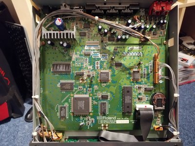

When I got my SC-55 two weeks ago I remembered seeing this thread:
The attachment IMG_20200122_123615.jpg is no longer available

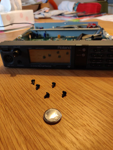

Thank you for this thread. I received my SC-55mkII this week and immediately checked the inside. The customs declaration explicitly stated there was no battery but there definitely was one. The white stuff was crusting around the seal. It would not have been possible to see without removing the battery from the horizontal holder. The board looked fine otherwise, thankfully.
Please, please, please check your units if you haven't yet. It looks like this is the time period where the internal batteries are just starting to self destruct and we can catch them in time. It's only five screws; rescue them.
