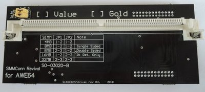

Hi,
I have only 4 left of the batch of assembled simmconn PCB's, then it is sold out.
So if you still need one in 2019, it is best to PM me to reserve it.
28.24 KiB
2180 views
If there's sufficient interest, I will have another batch made, by end of 2019 or early 2020.
Thanks for your support !
