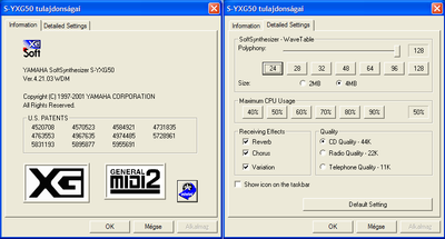

It's interesting that the XP version had these options to adjust CPU usage, switch between 2 and 4 MB or adjust sampling rate. The VSTi doesn't have that, but Evgeny maxed out all settings by default anyway and I doubt anyone would want to go lower.
That being said, wishing for an edition of the SCVA which is running with SC55 preset by default...
Reply 665 of 724, by Falcosoft
Trelokk wrote on 2022-02-18, 19:52:
1. In case of a VSTi plugin 'adjusting sample rate' does not have any sense since the VST host sets the sample rate and the plugin only gets the info of what sample rate is required by the host.
2. Measuring and constraining its own CPU usage would be also problematic from the plugin's side since it's just a dll that the host loads to its own process and CPU usage belongs to processes/threads that the host owns.
3. With the help of an ini file you can also define what other voice table file you would like to use instead of the embedded one:
INI file have to have the same name as the dll file, but with the ini extension. All settings have to be placed in the [SYXG50] section.
VoiceTable - Name of the voice table file. If not specified, SXGBIN41.TBL from the DLL resources will be used.
Process - Enables additional sound processing. The exact purpose is unknown. Disabled by default.
XGLite - If 0, Full XG will be used. If 1 or 2, restriction to the XGLite v1 or v2 will be enabled.
DebugPanel - Displays panel with detailed debug information instead of the standard user interface.
DisableGUI - Disables GUI completely. As the result VSTi works as the SGP.DLL from the Yamaha MidRadio 6.

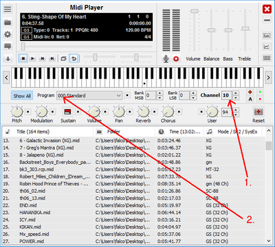

Reply 668 of 724, by Falcosoft
KainXVIII wrote on 2022-08-07, 13:05:
According to https://en.wikipedia.org/wiki/List_of_MT-32-c … _computer_games Return to Zork "was designed to be output via Roland SC-55 in MT-32 mode with GM percussion", how to do that with Roland SC VA + Falcosoft Midi Player? I managed to send custom sysex command gs_mt32-mode.syx (i'm doing this the right way?), but what about GM percussion part?
1. Yes, using GS_MT32-mode.syx is the right way to set SC-VA to MT-32 compatible mode.
2. You simply need to set the program of channel 10 to 0 (zero) instead of 127. Program 127 on channel 10 is the MT-32 compatible drum set and Program 0 is the default GM Standard set.
Website, Facebook, Youtube
Reply 669 of 724, by KainXVIII
Falcosoft wrote on 2022-08-07, 20:18:
Where is this option? 😮
Reply 670 of 724, by Falcosoft
KainXVIII wrote on 2022-08-07, 22:16:
On the main interface of FSMP:
53.02 KiB
1870 views
Reply 671 of 724, by KainXVIII
Falcosoft wrote on 2022-08-07, 22:41:
Thanks! SysEx option was much easier to find 😅
