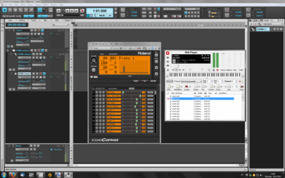

Reply 3 of 619, by James-F
Yes, it works with any midi input.
I use a small software called loopMIDI to rout all midi playback to an input which I use in my DAW (Sonar) with the Sound Canvas.

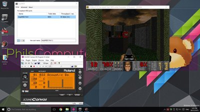

Now, how to use it?
Seeing this is a plugin, it what is a good host to use this with? It will need to appear as a MIDI device to Windows, so we can use DOSBox or ScummVM with it.
What free programs are recommended?
YouTube, Facebook, Website
Reply 16 of 619, by PhilsComputerLab
Rank Hardware Mod
Hardware Mod
Ok it seems to work now.
I used these two programs:
- loopMIDI
- SAVIHost
Here is a screenshot with Doom 2 in DOSBox 😀

Reply 17 of 619, by James-F
I was wondering when you'll show up phil.
Seems that with VSTHost sc-va stuck on the 8820 without being able to switch maps.
SAVIHost has the same bug?
Try the reset button or GM2 under system in scva, and see if you can change to sc-55.
Oh and hows the sound phil?

I have to play around a bit more. Currently I'm in AWE at the sound this thing generates 😊
This deserves a video tutorial I think 😀
EDIT: In Privateer, the SC-88 Pro mode appears to sound more "epic". I can certainly change the mode, reset it, that seems to work fine.
