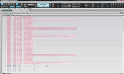

Oh, and here's an XG MIDI file that crashes even version 1.0.2.0:
https://static.kode54.net/AtlantisXG_TheShadows.mid

This midi you posted has the biggest SysEx command list I have ever seen.
SC-VA does not crash but takes several seconds to load the commands before it plays the music although without effects or the correct instruments.
S-YGX50 plays it like it should.
