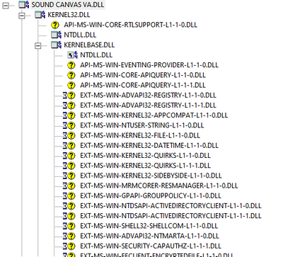

Reply 621 of 779, by Trelokk
So, I have also tried to get this working and couldn't until now.
System: Win10 x64 21H2
Installed: Sound Canvas VA v1.1.3, loopMIDI v1.0.16.27, SAVIHost v1.43 (savihostnkx64.zip)
What I have done:
- Made sure latest Visual C++ 2008 Redist is installed
- loopMIDI: Set up a new port, running in background
- SAVIHost: Copied it into C:\ProgramData\Roland Cloud\Sound Canvas VA (where SOUND Canvas VA.dll resides) and renamed it to SOUND Canvas VA.exe
When trying to launch SOUND Canvas VA.exe afterwards, I just get an 'Error loading "C:\ProgramData\Roland Cloud\Sound Canvas VA\Sound Canvas VA.exe". Please make sure that you renamed SAVIHost.exe to the name of the plugin DLL you're trying to use [...]'. Before that, I got the "side-by-side configuration is incorrect" error, but somehow I made that stop.
Any ideas how to get that stuff launched properly or is there another way?

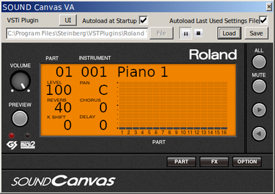

Reply 625 of 779, by realnc
Trelokk wrote on 2022-02-03, 16:07:
It's not a problem this the DLL is located in C:\ProgramData\Roland Cloud\Sound Canvas VA, right? That's where all the files seem to be, anyway.
I think it's in "C:\Program Files\Steinberg\VSTPlugins". The other DLL is like a loader for the real one.

Reply 628 of 779, by realnc
Trelokk wrote on 2022-02-03, 22:02:
There is a Steinberg directory, and it also has the DLL in it, but it's only 3 KB in size or something. It's the only file there, too. That can't be it.
Hm. I just checked and that's what I load. It's a 3kb dll, and I load it in Falco's MidiPlayer:
The attachment Screenshot_20220204_002755.png is no longer available
Reply 629 of 779, by Trelokk
Well, loading the 3KB file didn't do the trick for me, either, so I will have to keep investigating.
But yeah, when checking the DLL with Dependency Walker, I get quite a few errors about missing dependencies. Just need to figure out which:
"Error: At least one required implicit or forwarded dependency was not found.
Warning: At least one delay-load dependency module was not found.
Warning: At least one module has an unresolved import due to a missing export function in a delay-load dependent module."
Attached is a screen of a small part of the errors I see. Currently I only have installed an all-in-one package of the Visual C++ 2015-2022 redistributables.
In the meantime, I tried installing that trial version linked above. Well, what can I say, the 64-bit version works, just like that. I am loading the big 28 MB DLL from the "Program Files" folder and no problems at all. And yes, it installs the C++ 2010 redistributables.
TBH I dunno what kinda installer they gave me here, it's merely 25 MB while the one from the trial is almost 100. Looks to me as if there was quite some stuff missing? For sure it's missing the C++ redistributables since those won't be installed along with it at all. And it doesn't work with the C++ 2010 redistributables, neither x86 nor x64. It doesn't even come with any Roland Cloud installation whatsoever, which is alarming. My suspicion by now is that I actually bought a non-functional/incomplete version. The price was too good to be true in the first place, anyway (10 bucks, 🤣 - should have known better, but I guess I hoped to be lucky). Time to ask my money back on Paypal for this pathetic scam, I guess.
