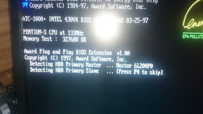

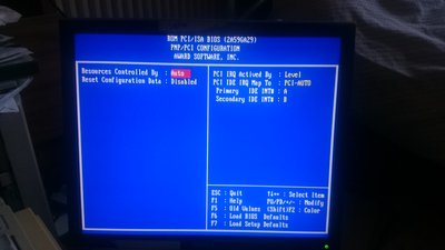

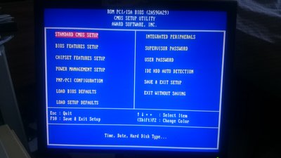

I don't have any options like here is my bios and it has a pnp/pci section and second pic Is defaults on that page and first is my POST saying type of motherboard and bios and tired the card is all slots and dosnt changed anything

Robhalfordfan wrote:I don't have any options like here is my bios and it has a pnp/pci section and second pic Is defaults on that page and first is my POST saying type of motherboard and bios and tired the card is all slots and dosnt changed anything
What are the alternatives to "Auto" under "Resources Controlled By" on this screen?
If there's no option under "Resources Controlled By" that helps get the midi to work, I don't really know what to do. I thought all AWE64's were pretty much alike, but maybe this particular model only produces midi in Windows -- or needs specific drivers or a TSR loaded to produce midi in DOS.

Postby Robhalfordfan » 2016-12-18 @ 10:46
it changes to manual and it lets you change the irq and dma to pnp isa/pci or legacy isa
