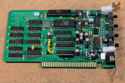

I have my blasterboard assembled and working. It sounds great.
I was hoping LABS could make progress with getting it working with the windows SB 2.0 drivers, so it could permanently replace the SB 2.0 card in my 286.
I hope the same. Never really managed to get Windows 3.1 to use the SB 2.0 drivers - on a real SB 2.0!
Using the supplied Sound Blaster 1.5 drivers worked like a charm, though.
Even with SB Pro clones, emulated Sound Blasters and in Win 3.1 Standard Mode, too.
Reply 404 of 533, by keropi
I also could not install the SB2.0 windows drivers with 3.1 or 3.11 - using a real CT1350B as well
I just gave up , maybe the drivers are 3.0 only or something

The SB2.0 drivers work fine for me in windows 3.1 standard mode on a 286 with an original SB2.0

I'll try to do my best to solve SB 2.0 drivers issue for w3.x, but I'm surprised that some of you guys have a separate card for that instead of using a better sounding BB with SB 1.5 driver, which works just fine. Any practical reason/titles? I already tried to solve it, but failed so far and switched to more important updates. However, if there is such a demand, I should disassemble the driver and look under the hood..

LABS wrote on 2020-01-30, 16:31:
I found an old article recently that mentioned problems with the Sound Blaster 2.0 drivers. The article claimed that the standard drivers tended to have problems on any system faster than a low-end 486. Creative released a "fixed" version, which the article claimed didn't work much better; they still had to disable the on-board cache just to get it to install properly. Their proposed solution on faster systems was to use the older drivers for the 1.5. Hopefully that can give some hint about what is going on.
Reply 417 of 533, by LABS
640K!enough wrote on 2020-02-17, 20:14:
Explains a lot, thx.
