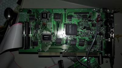

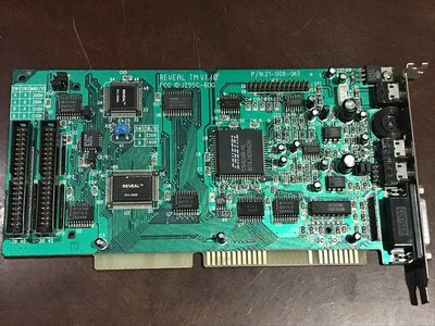

First post, by boxpressed
I just bought this Reveal card off eBay and can't find any information on it. I'm not sure if it is called the "TM" or if that is just a very large trademark. I think it is a clone of an Aztech card, but I don't know which one. I am considering peeling off the Reveal stickers but would rather not if anyone is already familiar with this card. Can anyone point me to a set of drivers?

Looks very similar to a board I have which came as a part of a bundle I bought new way way back. It was part of a complete multimedia upgrade kit with a double speed cd, sound card that looks a lot like the one you have there, speakers. Also a couple of cd titles (Megarace and Grolier). Can't recall the compatibility off the top of my head. I know I have the original installation floppies kicking about here somewhere.

Reply 8 of 18, by boxpressed
OK, I removed the sticker from the controller, and it is a CompuMedia (C-Media) ASC-9308. I never associated CompuMedia and C-Media until now. Anyone have drivers for it?
Reply 9 of 18, by darry
Assuming the other chip is DSP-9309A and according to Need help with sound card identyfication , you might want to try Terratec Maestro 32 (2nd edition) or Gallant SC-6000 drivers
See http://laurent.caprani.free.fr/sc-6000/#IDAUFM3

Reply 11 of 18, by darry
33oldnew wrote:
Looks like Terratec ProfiMedia (Maestro 16 SE IDE ?)
But the drivers, good question. I'd started trying Turtle Beach Monte Carlo 929. If not, then different Terratec Maestro 16.
Both of those are Opti 929 based . This Reveal TM V1.10 is not .
Reply 12 of 18, by boxpressed
I have taken the liberty to attach the pertinent files .
Thank you -- these drivers worked! Haven't done much testing other than the rudimentary, but it does seem to work just fine.
Reply 14 of 18, by zapedge
Its a clone of the Gallant SC6000. Also Terratec Maestro 16 is equal.
IMHO a very good Signal-To-Noise Ratio. Also non-PnP.
Drivers I use available @ http://terratec.ultron.info/Audio/Maestro/16/Driver/

Reply 16 of 18, by Slugbreath
Sorry, this maybe a bit late for you. I have just purchased a Mitac 4466 (486dx2/66) which has this exact soundcard (reveal v1.10, FCcC id: JZ5SC-60G), with a reveal cdrom player. It is a rebadged Voicon Systems Inc. (Taiwan) soundcard . The hdd seems to have dos and win 3.1 drivers on it (Reveal Sc400), so if needed, once I've reassembled it (currently stripped down to retrobrite the awful front panel) I can upload drivers...

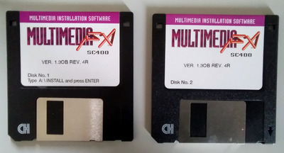

Reply 18 of 18, by gca
Not sure if these are the version you are looking for but here are the images of my driver disks for the SC400. They are the disks I got with a multimedia upgrade kit.
    75.35 KiB
    1546 views
    Photo of disk labels.
    sc400-disks.7z
    1.85 MiB
    56 downloads
    2 x floppy images (3.5" HD) compressed into one 7-zip file.
