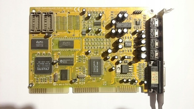

Reply 555 of 776, by zyga64
mt777 wrote on 2023-01-06, 00:43:
I have ALS100 Trump Audio wave32 Card is initialized but nothing hear on mpu. […]
Found drivers here: http://vogonsdrivers.com/getfile.php?fileid=815&menustate=0
DOS is inside TRUMP32.CPS archive
and works fine
AFAIR this card has SAM9233 connected to 0x388 port (usual opl2/opl3 location). Therefore old dos games sound "a little bit" strange 😀

Reply 557 of 776, by zyga64
I don't remember exactly how it worked, because I sold the card a few years ago, but the games that normally played FM audio using OPL3 (on other cards) on this card play it using SAM9233 wavetable. This card doesn't have FM chip at all.
