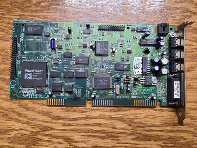

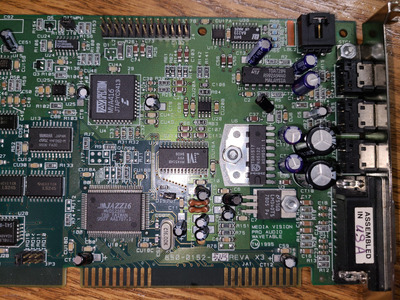

When I tested the card briefly today it was detected with the Add Non-PNP Hardware Wizard in Windows 98SE and mostly works with the default drivers. Sound effects are all good... all of the playback modes tested in DXdiag worked perfectly. OPL3 music works fine. However, unsurprisingly, when I tried to play back a .mid file with the MPU-401 selected the system would just repeatedly freeze until I forced it to reboot. If I pull the DISMPU jumper it no longer freezes when I do this, but I just get some odd ticking\static sound with no playback. I'm assuming the DISMPU jumper disables the wavetable header and the external MPU-401 interface. When you pull it off, those are enabled and the Wavefront chip is disabled. Putting it back on enables the Wavefront chip... which apparently Windows 98SE does not like with it's default Jazz16 drivers.

Nice one! The MV Jazz Wave (aka MediaVision PAW-200 Pro Audio) looks like a pretty complete sound card, would be interesting to see how wavetable sounds.

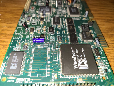

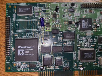

The ICS2125M-001 "waverom" on my card is apparently a 512KB ROM, where as other ICS Wavefront devices may use 4MB (2 x 2MB ROMs), 2MB, or 1MB sets.
I have attached the datasheets for the chips on this card. I'm not sure if there is a difference between the 2125M and the 2125, so I have included datasheets that mention both.
It looks like the 1MB and 2MB ROMs use a 44pin SOP... I wonder if that is what would go in the empty 44pin location on my card? If so, it's interesting that they bothered designing the card for either ROM and yet opted to sell it only with the cheapest one. Unless of course someone out there has one with a larger ROM?
