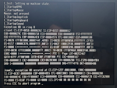

Reply 134 of 915, by vorob
I’ll be an ordinary person with “I’m following the guide but it’s not working, help me”
The laptop is Toshiba Satellite 5205 with sound device Yamaha F753 @ Intel 82801CAM ICH3-M - AC'97 Audio Controller [B1] PCI
Windows 98 installed, I’m entering dos via command prompt only option on f8 menu
My current config.sys only holds required option:
rem device=C:\DOS7\HIMEM.SYS
rem DOS=HIGH,UMB
DEVICE=jemmex.exe

jload qpiemu.dll
pause
hdpmi32i -r -x
pause
sbemu
pause
That's what i have when loading command line, looks perfectly fine. (Sorry for some mistakes, it’s phones ORC)
JennEx u5.84 [02/06/23]
System memory found at e800-efff, region might be in use
Using page frane d000
JennEx loaded
Then
C:\> jload gpienu.dll
JLoad: 'gpienu.dIl' loaded successfully.
C: hdpmi32i -p -x
HDPMI32 now resident
C: \>sbenu
Found sound card: ICH AC9?
Real mode support: enabled.
Protected node support: enabled
OPL3 emulation enabled at port 388h.
Sound Blaster Pro enulation enabled at Adress: 220, IRQ: 7, DNA: 1
But then I run doom or duke3d and they both crash with wall of text…

Reply 135 of 915, by Bondi
vorob wrote on 2023-03-12, 09:03:
I’ll be an ordinary person with “I’m following the guide but it’s not working, help me” […]
rem DOS=HIGH,UMB
DEVICE=jemmex.exe
rem device=C:\DOS7\EMM386.EXE
rem device=C:\DOS7\IFSHLP.SYS
rem Install=C:\DOS7\clarus.com /q
rem Country=007,866,country.sys
I also created simple bat file to run all other commands and see how it goes:
jload qpiemu.dll
pause
hdpmi32i -r -x
pause
sbemu
pause
JennEx loaded
Then
C: hdpmi32i -p -x
C: \>sbenu
Try adding NOAUTO to DOS=HIGH,UMB string.
I think I had problems when it was not there.
