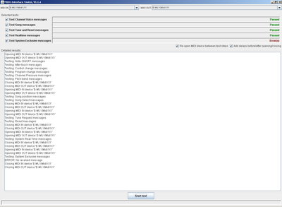

Reply 17 of 44, by mattw
just an addition to my previous posts: "E-MU Xmidi 1x1" USB adapter fails with SysEx messages 1151 bytes in size or bigger:
26.64 KiB
1464 views
I've just found that adapter in a box of old hardware I recently acquired. so, it's like M-Audio hit and miss when it comes to SysEx - it can work in some cases and for some applications and fails for another. so, yeah, when it comes to USB MIDI, most devices are crappy, with very few exceptions.

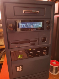

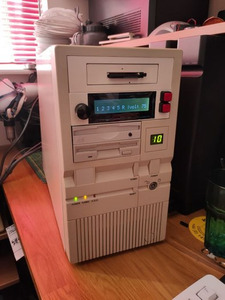

Reply 19 of 44, by megatron-uk
mattw wrote on 2023-11-27, 21:16:
megatron-uk wrote on 2023-11-27, 21:12:
use it with mt32-pi
IMHO, using MT32-Pi is simply waste of money. you can buy thin-client for a fraction of those money run not just MT-32 emulation, but all the other available emulation plus even go fancy with very high-end sound card in that thin client, for example I have Futro with T56N, that I mentioned here:
In my case the mt32-pi is used because of the size - I have it integrated into a 5.25" drive bay in my 286 and 486DLC machines. The cost was limited to just the LCD screens as I already had surplus Pi3 boards and boxes full of buttons etc.
The intention was to have a standalone retro PC with MT32 and GM support, at a reasonable cost, which it definitely achieved.
