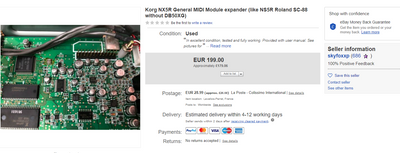

Reply 4 of 12, by ras2a
Great thread... I've just ordered a second hand NX5R and I already have a Dreamblaster S2... 2 questions:
1) Will adding this to my NX5R do any damage (based on the power issue described above) or would it even work....
2) What are the real advantages of adding one of these in? It obviously wouldn't give me 'XG' support would it? For that, I assume I'd need the actual Yamaha daughterboard (DB51X?)
Thanks guys
Reply 5 of 12, by imi
afaik the NX5R has the yamaha board already installed, that's what differentiates the NX5R from the NS5R in the first place.
so to use a dreamblaster you'd have to remove that, rather save the dreamblaster for something else? ^^
Reply 6 of 12, by ras2a
imi wrote on 2020-06-05, 10:40:
Well that's what I thought, but the one I just bought doesn't have anything inside according to the seller....
Reply 7 of 12, by imi
someone probably bought it to nick the wavetable board and resell it again then 😒 that's unfortunate, I hope you didn't pay that much for it :x
but yeah, in that case you can just put the dreamblaster in I guess, the NX5R should already be set up properly for it I assume.
Reply 8 of 12, by ras2a
Yeah that’s what i thought. No I put a cheeky offer in and got it for quite a bit less
