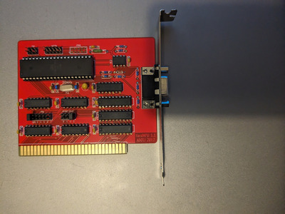

I have a MT32 (old model) in my 486 DX2/66 system and I am having a weird issue in Wing Commander 2 using hard MPU card. For some reason, some notes like the explosion of the Tiger's Claw in the intro are wrong. Here is my system Specs:
Intel DX2/66
16MB RAM
AOpen AP43
Matrox Mystic 4MB
Sound Blaster AWE32 CT2760
Roland MT32 (old version)
Hard MPU 1.1 from Abotj
I have setup the MPU401 from the AWE32 to 300 and Hard MPU at 330. When I use SoftMPU with the AWE32 on 330 it seems to work properly. I tried with a AWE64 and I have the same issue.

Reply 6 of 19, by Pickle
what about trying a different serial cable? Is the baud fixed on these hardmpu cards?
how are you slowing down the system, like disable L2 cache?
your sound sample does sound like the custom samples are not working. The usual signs are the fireworks, dinging bell when the ships shoot, and a horn when the water drop drips in the barracks.

Pickle wrote on 2024-03-14, 12:25:
Maybe the Isa bus is overclocked?
Ok, I'm going nuts with this issue. I found out that the Bios has a "Engineer Mode" where you can change the AT Clock. It was set at 7.159Mhz. I changed it to CLK/4 and it seems to be working.
But now, My AWE32 CT2760 which has jumpers to specify the MPU401 address keeps showing a MPU401 on port 330 when it's physically configured to 300.
I use Unisound to initialize the card and my SET BLASTER is correctly configured to 300 but Unisound keeps showing that the card's MPU401 is initialized at 330 !? If I remove the HardMPU, it's shows correctly. It's like Unisound see's the HardMPU address for it's MPU041 and assign's it to the AWE32 for some reason.
I will try Creative's drivers to see if I have the same issue. I am starting to wonder if the BIOS is corrupted or something. I get inconsistent results at evey try...
