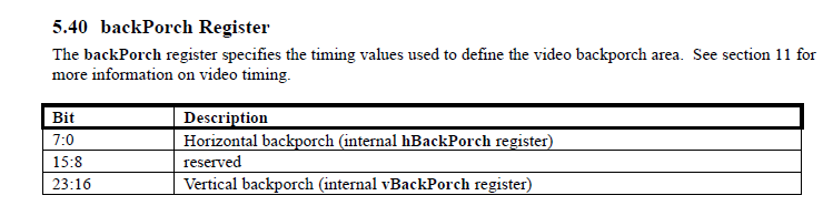

I have shifted image on aver c127, under windows 98se and using something like TNT2 I can shift image manually by PowerStrip, but when Glide activates it still shifted right at 6-8 pixels.
20170124175736-png.120657
In glide mode I tried to play with SSTV2_BACKPORCH variable, but still nothing ((
https://youtu.be/YdilJR8oZs8
Reply 10 of 10, by jack7277
well, I found a solution.
it is two variables for v1 and v2
SST_BACKPORCH
SSTV2_BACKPORCH
2017-01-26_08-59-13-png.120753
and in bat file it will be something like that
SET SSTV2_BACKPORCH=0x1D001D
and tada!
20170126093207-png.120754
