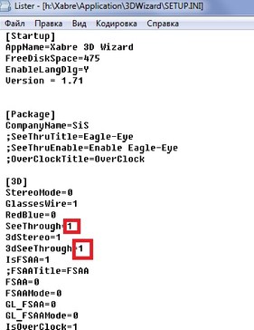

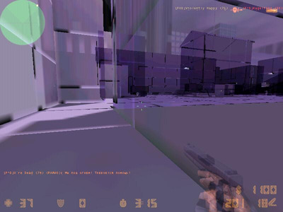

Does anyone know where I can download the driver that enables the Eagle-Eye: Wireframe and Transparency features on SiS Xabre cards?

I am still looking for those drivers. They have to iclude the 3D Wizard version 1.6.
http://www.3dvelocity.com/reviews/SiS%20Xabre400/xabre3.htm
I need the following drivers to check if the egle-eye option is included there:
- 3.01.02
- 3.02.53
@ B.Gumble, What version do you have? I can see there is 3D Wizard, but you would have to check if there is Eagle-Eye option. It is not always there.
I used the 3.57.53 drivers - 3D Wizard is there but no Eagle-Eye option 🙁

Reply 7 of 15, by VooDooMan
So far no success...
I tired the following drivers:
3.02a.02 (3021) - no 3D Wizard
3.02.53 (3020) - no 3D Wizard
3.06.1.02 (3060) - no 3D Wizard
3.09.52 (3090) - 3D Wizard is there, no eagle eye
3.10 (3100) - 3D Wizard is there, no eagle eye
3.57.53 (3570) - 3D Wizard is there, no eagle eye

Reply 13 of 15, by Tuxality
I've just saw this thread, 3D Wizard is just a mere registry editor, nothing more than that. You don't need it, the functionality is present in the drivers, just try to set SeeThrough (should be SiS.3D.SeeThrough in registry?) to value higher than 0 in a similar fashion to setting TexTurbo in Xabre drivers. Should work for both, Direct3D and OpenGL.
Reply 15 of 15, by Vogon Will
it works!
download this
https://archive.org/details/sisvga-v-14.7z
first edit aplication\3dwizard\setup.ini
23 KiB
532 views
1 intall utility and driver
2 install 3D wizard
